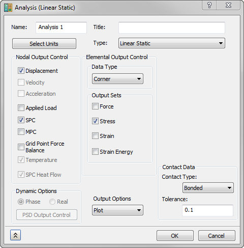

When you first start the Autodesk® Nastran® In-CAD environment, an analysis is created automatically for you. The analysis has certain default settings activated. To modify these settings, click Edit from the same panel. To create a new analysis, click New from the Analysis panel. In both cases, the Analysis dialog opens:
In this topic, we will explore the most commonly used settings in the Analysis dialog. For a description of all of the analysis settings, please see the Analysis topic in the User's Guide section.
Note that for models containing multiple analyses, a different unit system can be assigned to each analysis. This setting only applies to the Nastran Bulk Data file that is written out. You will not see a difference in the numbers entered in the user interface.
Select the analysis from the list in the Type menu. Autodesk Nastran In-CAD supports a wide range of analysis capabilities. It is important that you understand the requirements, outputs, and limitations of a analysis type before using it for the first time. Autodesk Nastran In-CAD supports the following analysis types:
You can use the Nodal Output Control and Elemental Output Control options to control the quantities written out at the conclusion of the analysis.
For more information, please see the New Analysis topic.
Set the default settings for generating Automatic contacts.
