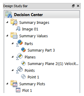

Use the Decision Center to manage all summary items:
There are three principal components of the Decision Center:
Use Summary Images and the Design Review Center to visually compare results from multiple scenarios. It is a good way to compare flow and thermal performance of two or more scenarios in a design study.
Compare results either by incrementing through a set of scenarios in a single view or by positioning multiple images side-by-side.
Use the Design Review Center to answer questions like "Which design produces the most uniform flow distribution?" and "Which design keeps the critical components coolest?"
Use Summary Values for comparing results from individual and multiple scenarios.
There are three types of Summary Entities. Each answers questions such as "What is the maximum temperature?", "Which design produces the lowest pressure drop?", "Does the velocity at a point near a critical component exceed a design limit?"

Summary Points are locations within a model on which specific result quantities are monitored. Summary Points are ideal for:
Use Summary Points to answer questions like: "Which design produces the most uniform velocity or temperature distribution across a set of points?" and "Does the pressure at a point near a critical component exceed a design limit?"
The Summary Values table lists results from Summary Items. The table provides a simple way to quickly extract, present, and compare results from individual and multiple scenarios.
