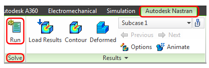

The default analysis setup is suitable for this simple linear static stress analysis example. We can proceed immediately to running the solution.
Click Autodesk Nastran Solve Run.
