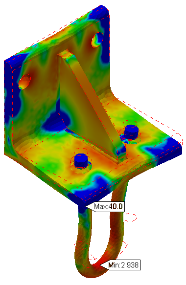

  1. From the Result Data pull-down menu, choose SAFETY FACTOR.
    1. Activate the Specify Min/Max checkbox.
    2. Type 40 into the Data Max input field. This value produces a fuller, and more meaningful, color spectrum on the contour plot.
      Tip: The actual maximum safety factor is many times greater than the minimum value, which skews the contour color towards red for most of the model. Reducing Data Max, which reduces the range of the plot legend, eliminates the skewed contour problem. Resolution is lost at the higher safety factor values, which appear as dark blue (in this case, those over 40). This is inconsequential, since the low safety factor values are the ones of interest.
    3. Click Display. Your safety factor contour plot should be similar to the following image:

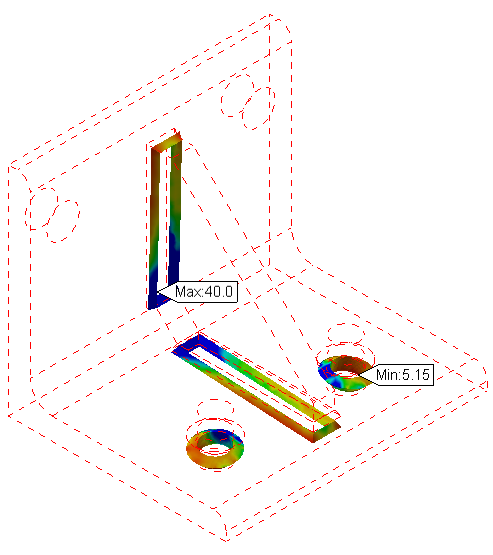

    4. Click on the Part View tab of the Plot dialog box.
    5. In the model canvas, click on one of the weld beads to select the Welds part. The part name appears in the Selected Parts list within the Plot dialog box.
    6. Click on the Contour Options tab of the Plot dialog box.
    7. Once again, type 40 into the Data Max input field. (Reducing the number of displayed parts reset the data range.)
    8. Click Display. Zoom in for a better view of the welds if desired. Your safety factor contour plot should be similar to the following image:
