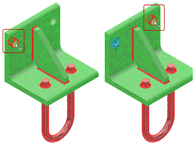

The welded steel hanger is bolted to a wall that is not included in the CAD or simulation model. Fully-fix the surfaces of the two holes through which the hanger is bolted to the wall. Additionally provide a constraint against translation in the X direction at the bottom outside corner of the angle. This second constraint represents the support of the wall, which prevents the corner from moving in the –X direction when the load is applied.
Tip: The location of the fixed constraint and the applied load, and the direction of the load and support reaction forces, produce a moment that tries to rotate the angle. The reaction couple formed by the constraints at the mounting holes and bottom corner oppose this moment.

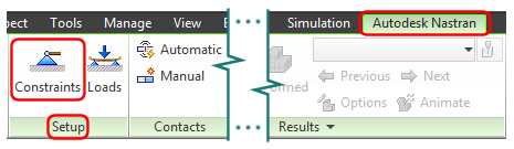

  1. Click Autodesk Nastran Setup Constraints.
    • The default type of constraint is structural and fully fixed. All degrees of freedom (DOF) are constrained. This setting is appropriate for the hanger mounting holes.
      In the model canvas, click each of the mounting hole surfaces to select them.
      The selected faces appear in the Selected Entities list within the Constraint dialog box.

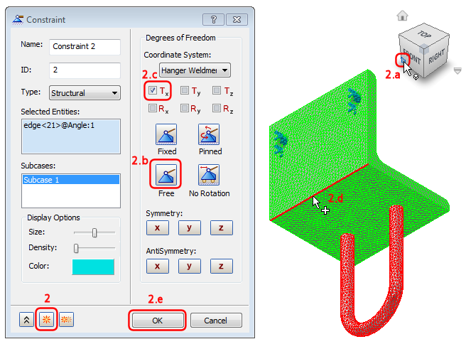

  2. Click the New button near the bottom left corner of the Constraint dialog box to add a second constraint.
    Refer to Figure 2 – 2.e for the this step and the following five steps.
    Figure 2 – 2.e
    1. Click near the bottom left corner of the ViewCube to change the model viewpoint. This is the corner where the FRONT, LEFT, and BOTTOM faces of the ViewCube meet. The corner of the ViewCube turns blue when the cursor is in the correct clicking zone. The corner edge to be constrained is clearly visible in the new model viewpoint.
    2. Click the Free button in the Degrees of Freedom section of the dialog box. This button deactivates all of the individual DOF checkboxes.
    3. Activate the Tx checkbox to specify that only translation in the X direction is to be constrained.
    4. In the model canvas, select the bottom outer corner of the angle.
    5. Click OK to accept the second constraint and exit the Constraint dialog box.

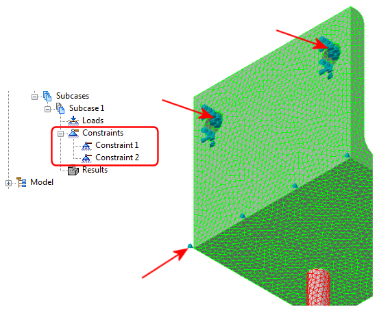

  3. To be sure that you have correctly applied the constraints, compare your browser and model appearance to the following image:
