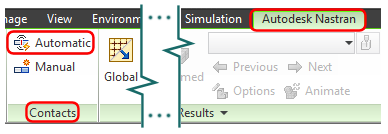

  1. Click Autodesk Nastran Contacts Automatic.

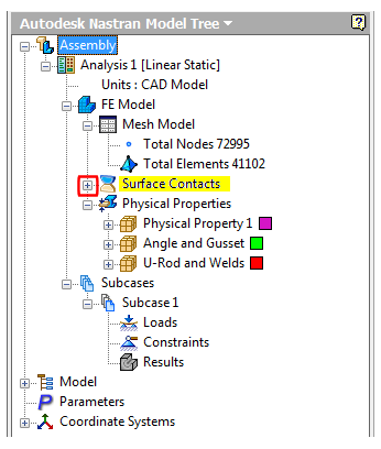

  2. Expand the Surface Contacts sub-branch in the Assembly branch of the Autodesk Nastran Model Tree.

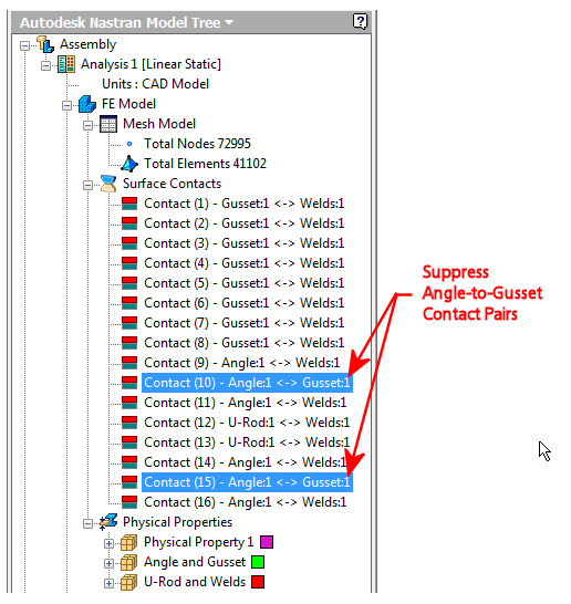

  3. You should see sixteen contact pairs that were discovered. Locate the two pairs that represent contact between the angle and gusset parts. We will suppress contact at these two locations so that the loads are carried from part to part only through the welds.

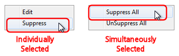

    • Right-click and suppress each of these two contact pairs from the appropriate command in the context menu. You can suppress them individually or simultaneously. Depending upon which method you choose, the context menu commands are different, as shown in the following image:

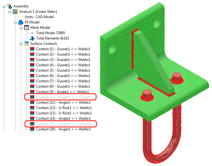

      The browser and model should look like the following image. Note the different appearance of the suppressed contact pairs.
