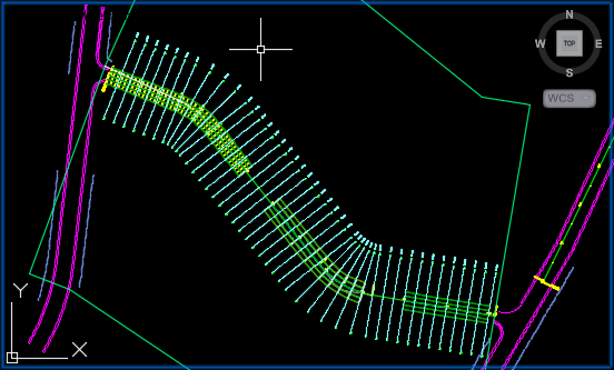

You can use AutoCAD Civil 3D rehab corridor modelling to optimise the crossfall of rehab corridors, such as roads and highways.
Just like any other AutoCAD Civil 3D corridor model, a rehab corridor model builds on and uses various AutoCAD Civil 3D objects and data, including subassemblies, alignments, profiles, surfaces and targets. The rehab corridor manages the data, tying various rehab subassemblies (applied for different ranges of chainages) to the baselines and their finished gradient profiles.
Once you have created your rehab corridor model, the corridor name is displayed in the Corridors collection on the Prospector tab. You can perform any edits on it that you would perform on a standard corridor model. You can add additional non-rehab subassemblies to your rehab corridor as well. See About Subassemblies for more information.
