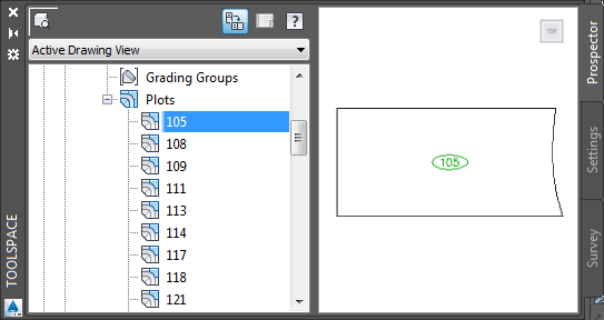

A graphical view displays an image of the selected item. The following illustration shows a Prospector graphical view of a plot.
To view graphical item previews, you first click the Item Preview button
on the Prospector tab. Then right-click the object or object collection and select Show Preview. Then click on the object name in the Prospector tree.
Right-click in the graphical preview to display a context menu that allows you to manipulate the image using commands such as and .
