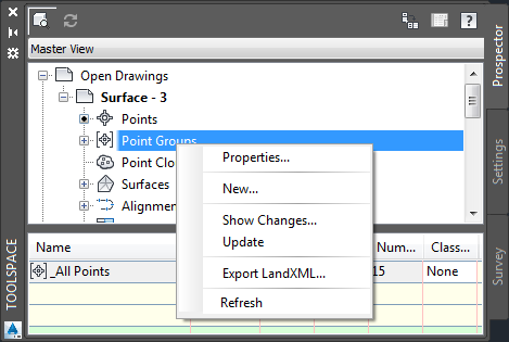

Display a context menu for any collection or item in the tree by right-clicking the item. The menu contains commands that apply to the item you selected in the tree.

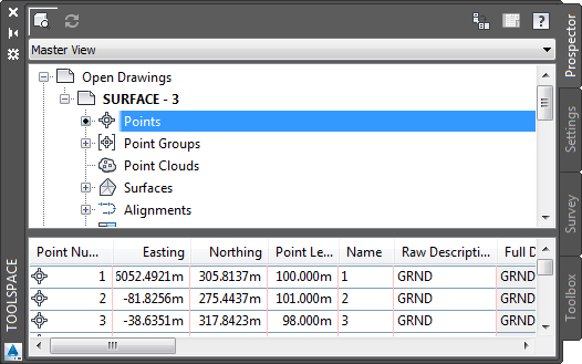

When you select items in the tree, additional information may be displayed in an item view, which is shown in a pane next to or beneath the main tree. You can adjust the size of the item view by moving the bar that separates the item view from the tree.
An item view is one of the following, depending on the item selected:
For more information, see About the Toolspace Item View.
