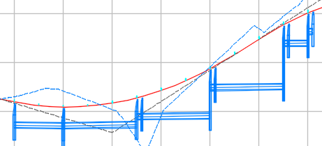

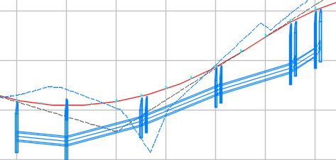

Following is a before and after example of analysis results for a pipe network shown in profile view.
| Pipe network before resizing
Pipe network after resizing

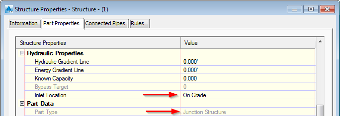

- Inlets are typically created in AutoCAD Civil 3D as junction structures with an Inlet Location property of On Gradient or On Sag.
- Manholes are typically created as junction structures with an Inlet Location property of<none >.
