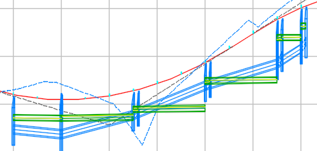

After specifying the exported file name and location and saving the file, you can transparently zoom and pan (enter 'z or 'p at the command line) to an existing profile view to see a preview of the EGL, HGL, and pipe changes. The colors shown in profile view are specified in the Analyze Pipe Network Settings dialog box, which you can access from the General page of the wizard.
The following illustration shows the existing pipe network in profile view.
The following illustration shows how the preview graphics might appear. In this case the analysis determined that smaller pipe sizes could be used for the selected AEP.
In the preview, structure depths are not adjusted because they are connected to the original pipes rather than the resized ones. However, when the results are applied to the pipe network, the structure depths are adjusted to accommodate the adjusted pipes, as shown in the following illustration.
The following illustration shows a detail of the EGL and HGL lines in the preview.

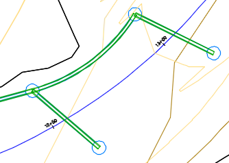

A preview of the resized pipes is also shown in plan view.
