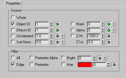

Source group
Lets you select any G-Buffer data in the scene that will have a highlight applied to it. Lens Effects Highlight will begin the process by finding the source pixels from your scene that you want to glow.
- Whole
- Lets you apply highlights to the whole scene, not just a particular piece of geometry. This, in effect, makes each pixel in the scene a potential highlight source. The areas of the scene that have highlights applied to them are determined by the settings in the Filter section of the dialog.
- Object ID
- The Object ID Lets you apply highlights to particular objects in your scene that have a corresponding G-Buffer (or Object) ID. The G-Buffer is a geometry buffer and can be defined when you right-click any 3ds Max object and select Properties from the menu. Then, set the Object Channel ID under the G-Buffer ID controls. This parameter can be animated.
- Effects ID
- The Effects ID lets you apply the highlight to an object or part of an object with a specific Material ID assigned to it. Material IDs are applied in the Material Editor. See G-Buffer. This parameter can be animated.
The highlights are then only applied to areas of the geometry where that particular ID is present.
Note: In many instances, you might want to apply different highlight settings to different pieces of geometry or IDs. To accomplish this, add additional Lens Effects Highlight entries to the Video Post queue. Then set each different Highlight entry to effect a different Material or Object ID and proceed.
- Unclamped
- An unclamped color is brighter than pure white (255,255,255). 3ds Max keeps track of these "hot" areas which tend to show up when your scene contains bright metallic highlights or explosions. This spinner lets you determine the lowest pixel value that is highlighted. Pure white has a pixel value of 1. When this spinner is set to 1, any pixels with a value above 255 will be glowed. You can invert this value by clicking the I button to the right of the spinner. This parameter can be animated.
- Surf Norm
- Highlights part of an object, based on the angle of the surface normal to the camera. A value of 0 is coplanar, or parallel to the screen. A value of 90 is normal, or perpendicular to the screen. If you set Surf Norm to 45, only surfaces with normal angles greater than 45 degrees will be glowed. You can invert this value by clicking the I button to the right of the spinner. This parameter can be animated.
- Mask
- Highlights the mask channel of an image. The spinner value represents the level of grayscale present in a Mask. When this is set, any part of the Mask images larger than the set value will be glowed in the final image. You can invert this value by clicking the I button to the right of the spinner. This parameter can be animated. Range = 0 to 255.
- Alpha
- Highlights the alpha channel of an image. The transparency of an alpha channel is interpreted opposite that of the Mask channel. Values range from 0 to 255. This parameter can be inverted by clicking the I button to the right of the spinner, and can also be animated.
- Z Buffer Hi and Lo
- Highlights objects based on their distance (Z-Buffer distance) from the camera. The Hi value is the maximum distance and the Lo value is the minimum. Any objects between these two Z-Buffer distances will be highlighted. These parameters can be animated.
Filter group
Filters the Source selections to let you control how the highlight is applied. For example, you can have ten spheres in your scene, each with the same Object ID, but different colors. If you set the source as the Object ID of the spheres, which selects all of the spheres, that is the only place in your scene that Highlight will apply an effect.
However, now that Highlight knows where the pixels are that can be highlighted, it needs to know which ones to actually apply the highlights to. Highlight uses the filter controls to find out which source pixels to apply the highlight to.
- All
- Selects all source pixels in the scene and applies a highlight to them.

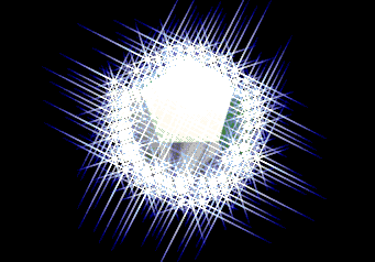

Edge highlights

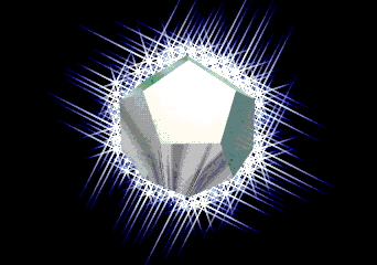

- Perimeter Alpha
- Applies a highlight only to the perimeter of an object based on its alpha channel. Selecting this option highlights only the outside of an object without any spill on the interior. Whereas highlighting by Edge produces a spill onto the object, Perimeter Alpha keeps all of the edges clean because it relies on the scene alpha channel to derive it's effect.
Perimeter alpha highlights
