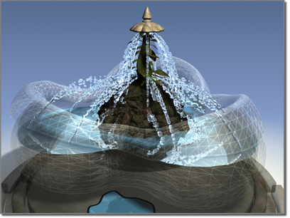

Fountain spray created as a particle system

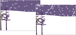

Snowstorm created as a particle system
