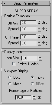

Basic Parameters rollout
These items control the direction and spread of particles.
Particle Formation group
- Off Axis
- Affects the angle of the particle stream off the Z axis (along the plane of the X axis).
- Spread
- Affects the spread of the particles away from the emission vector (along the plane of the X axis).
- Off Plane
- Affects the angle of emission about the Z axis. This has no effect if Off Axis is set to 0.
- Spread
- Affects the spread of the particles about the Off Plane axis. This has no effect if Off Axis is set to 0.
