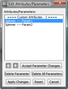

To edit a parameter or custom attribute:
- Select the object.
- Open Parameter Editor.
- From the Add To Type drop-down list, choose the type of parameter to edit, and then click Edit/Delete.
The Edit Attributes/Parameters dialog opens.

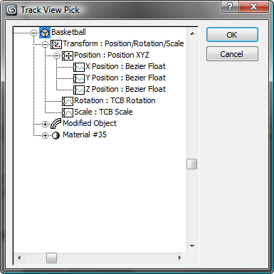

Note: If you chose Add To Type
Picked Track, the Track View Pick dialog might open first to prompt you to choose the animation track whose attribute to edit.
- In the Edit Attributes/Parameters dialog, highlight the parameter to edit.
Its settings appear in the Parameter Editor.
- Change the settings in the Parameter editor, and then click Accept Parameter changes.
- With multiple parameters or custom attributes, to change the ordering, click the entity to move, and then use the up and down arrow buttons to move the entity in the list. Moving a Custom Attributes entry also moves its parameters.
Note: You cannot rename a Custom Attributes entry.
- When finished editing, click Apply Changes, and then exit the dialog by clicking the Close or Cancel button.
To delete a custom attribute or parameter:
- Open the Parameter Editor.
- From the Add To Type drop-down list, choose the type of parameter to delete, and then click Edit/Delete.
Picked Track, the Track View Pick dialog might open first to prompt you to choose the animation track from which to delete the attribute.
- In the Edit Attributes/Parameters dialog, highlight the parameter to delete, and then click Delete Parameter. Alternatively, to delete all parameters under the same Custom Attributes heading as the highlighted parameter, click Delete All Parameters.
To delete one or more custom attributes instead, click a Custom Attributes heading, and then click Delete Attribute or Delete All Attributes. Multiple attributes can result from collapsing an object's stack with Preserve Custom Attributes on. For example, one set of custom attributes might be applied to an object and a second set of attributes assigned to one of its modifiers. Collapsing such an object results in two sets of custom attributes.
- Click Apply Changes, and then close the dialog by clicking its Close box or the Cancel button.

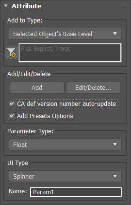

The Parameter Editor takes the form of a dialog with three rollouts: The first rollout sets general options for the attribute; the central rollout sets options for the current parameter type; and the third lets you preview the attribute user interface (UI).
Attribute rollout
Add to Type group
- Add to Type list
- Choose whether the custom attribute is assigned to the selected object, its active modifier (as highlighted in the modifier stack), its material, or a picked track. Also use this drop-down list to choose the attribute type to delete or edit.
If the text “Pick Explicit Track” appears in the box below the drop-down list before you choose Picked Track, the Track View Pick dialog appears showing the Track View hierarchy. Expand the hierarchy as necessary, click the track to add the attribute to, and then click OK.
Note: If you choose Selected Object's Current Modifier and multiple modifiers are highlighted in the stack when you click Add, Parameter Editor applies the custom attribute to the first modifier you highlighted and removes the highlighting from the other modifiers.
Pick Explicit Track
- Click this button to open a Track View hierarchy window from which to choose an animation track. Navigate the hierarchy to find the desired track, highlight the track, and then click OK. The controller information for the track then appears in the text box to the right of the button, and the Parameter Editor will then use this track for adding or editing custom attributes and parameters.
Add/Edit/Delete group
- Add
- Applies the custom attribute parameter to the current object, modifier, material, or track, depending on the current choice in the Add To Type list.
If a custom attribute parameter is assigned to an object or modifier, you can see and edit its value on the Modify panel after adding it by activating the entity to which the attribute is assigned. If the custom attribute is assigned to a material, it's available for that material in the Material Editor. To access a parameter that's assigned to an animation track, open Track View, highlight the track's Custom Attributes entry, and then right-click and choose View Attribute Dialog.
- Edit/Delete
- Opens the Edit Attributes/Parameters dialog.
This dialog displays a list of all of the custom attribute parameters assigned to the current object at the current level. Dialog behavior is described in these two procedures:
To edit a parameter or custom attribute and
To delete a custom attribute or parameter.
- Add Presets Options
- Allows you to create, load, and save presets where available.
Parameter Type group
- Parameter Type
- Use the drop-down list to choose the data type for the current parameter. The following list includes links to the sections describing the UI settings for each parameter's data type:
UI Type group
- UI Type
- Selects the type of UI element that controls the parameter.
The UI types available depend on which parameter type you specify. For example, float and integer values are controlled by spinners or sliders, and Boolean values by checkboxes or check buttons. Array values are always controlled by drop-down lists, node values by pick buttons, color values by color pickers, and texture map values by map buttons.
Full descriptions of each UI Options rollout follow, and the list of parameter types, above, includes links to the respective UI Options rollout descriptions.
- Name
- The name of the parameter. Parameter Editor gives the parameter the default name Param#, with # being a number. Change the name by editing this field.

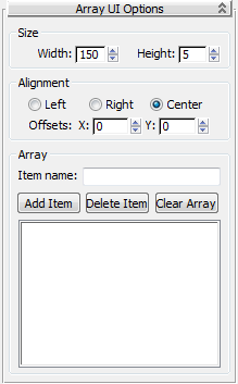

Array UI Options rollout for drop-down lists, combo boxes, and list boxes
Thess are the options for controls that let the user choose a named option from a list. The options for the three Array UI types are the same; they differ in how they appear on the Custom Attributes rollout. The types are:
- Drop-Down List: Only the current choice is visible by default. The user clicks the field to open the list and then clicks to choose a different item.
- ComboBox: Displays an editable field above a list box. The user clicks to choose from the list, or edits the field.
- ListBox: Displays a list. The user clicks the desired item; the highlighting indicates the current choice.
Size group
- Width
- Sets the width of the list.
- Height
- Sets the height of the list.
Alignment group
- Left/Right/Center
- Sets the alignment of the drop-down list in the rollout.
- Offsets X/Y
- Fine-tune the position of the array list on the horizontal and vertical axes.
Array group
- Item name
- Lets you enter a name into the list.
Click Add Item to add the name to the array list. To remove an item, highlight its name and click Delete Item. Click Clear Array to remove all items from the list.
- [array list]
- Displays the contents of the list.
The item at the top of the array list is the default selection.
