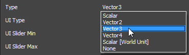

To create a float value in the shading network:
- Create an Input
Material Variable node, then choose Scalar or Vector 3 or Vector 4 from the Type drop-down list on the Properties panel.
- Give the Material Variable node a meaningful name; for example,
Blend.

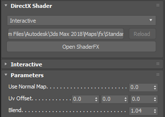

Naming your Interactive nodes makes it easier to find them on the Material Editor
Parameters rollout.
- Wire the new node to an appropriate location in the shader graph.
The Interactive Parameters rollout does not update until a new node is correctly wired.
- Minimize the ShaderFX editor. On the Interactive Parameters rollout, use the new control to set the value.

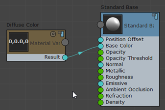

To create a color value in the shading network:
- Create an Input
Material Variable node, then choose Vector 3 or Vector 4 from the Type drop-down list on the Properties panel.
Note: You can connect any combinations of float1–4; that is, you can connect a float3 port to a float4 port, for instance.
DiffuseColor.
Parameters rollout.

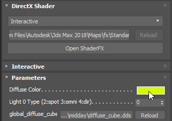

- Minimize the ShaderFX editor. On the Interactive Parameters rollout, use the new control to choose the color.
In the ShaderFX editor, the node's preview swatch now shows the new color.

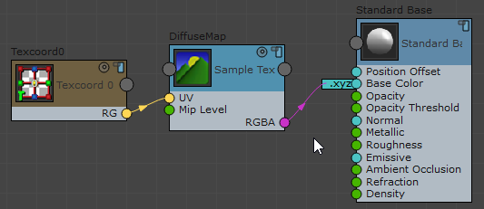

To create a texture map:
- To create a texture map, create a Sampling
Sample Texture node.
- Give the Sample Texture node a meaningful name; for example,
DiffuseMap.
Parameters rollout.
- Create a UV node (for example, Vertex Inputs
Texcoord0) and wire it to the UV input of the Sample Texture node.
If you don't provide the Sample Texture node with coordinates, the ShaderFX editor flags an error when you try to wire the Sample Texture to another node's input.
- Wire the new Sample Texture node to an appropriate location in the shader graph.

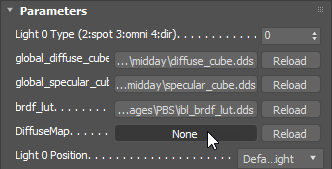

- Minimize the ShaderFX editor. On the Interactive Parameters rollout, use the new control to choose the map.
In the ShaderFX editor, the node's preview swatch now shows the new texture map.
