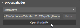

  1. Apply a DirectX Shader material to an object.
  2. On the DirectX Shader rollout, choose Interactive from the drop-down list.
  3. Also on the DirectX Shader rollout, click Open ShaderFX.
