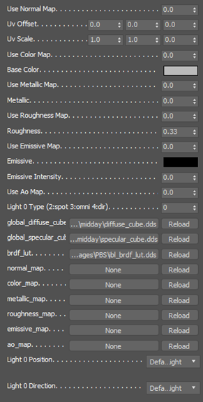

When you edit the shader graph, controls on the Parameters rollout update to reflect the current graph.
Parameters rollout for the default preset Interactive shader
