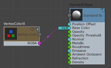

  1. Create a Custom Interactive shader (the new graph should have only a Standard Base node).
  2. Create a Vertex Inputs Vertex Color 0 node (drag and drop from the Node Browser to the work area) and connect it to the Base Color attribute of your Standard Base node.

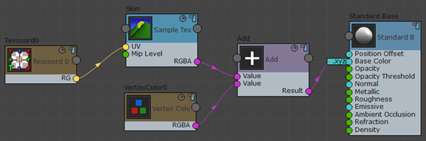

  1. Open the ShaderFX Editor again.
  2. Delete the wire that connects the VertexColor0 node to the Standard Base node.
  3. Add a Sampling Sample Texture node to the graph. Add a Vertex Inputs Texcoord0 node to the graph, and connect it to the UV input of the map node. Give the map node a readable name (for example, Skin).
  4. Add a Math Add node to the graph, just to the left of the Standard Base node.
  5. Wire the Texture and Vertex Color nodes to the Value inputs of the Add node, then wire the Result of the Add node to the Base Color input of the Standard Base node.
  6. Minimize the ShaderFX Editor.
  7. On the Material Editor, assign a texture to the new Texture map.
  8. Use VertexPaint to paint on the object again.
    Now the Add node combines the texture and the VertexPaint colors.
