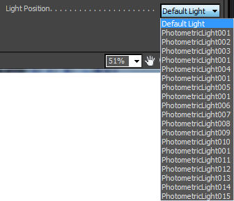

Light Support
Typically FX shaders are coded to use a specific number of lights: usually just a single light. If the FX file you open is coded this way, the shader-specific rollouts display a control that lets you pick the light to use. For example:
XMSL shaders, on the other hand, are not coded to use specific lights, so they use all active lights in the scene.

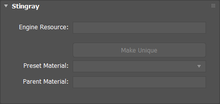

Interactive Rollout
Note: In 3ds Max 2018 Update 4, the Stingray physically-based shader is renamed Interactive.
The Interactive rollout is used with Interactive shaders.
Engine Resource
The path mapping the material to the Max Interactive engine. This is required since all materials are not included in FBX files, only the ones applied to a node in the scene. If an object is sent from 3ds Max Interactive to 3ds Max, the object's material is automatically mapped to the engine resource. Once the engine resource is mapped, if the material changes in 3ds Max Interactive and is then sent to 3ds Max, the properties will automatically update in 3ds Max.
Make Unique
Opens the Shader Graph Editor.
Preset Material
To avoid repeatedly creating identical shader graphs, you can create and save a preset shader graph and then reuse the preset next time you create an Interactive shader.
Parent Material
A material containing a preset shader graph. You can create child materials based on a parent material. A child inherits the shader graph and material attributes from the parent material.
