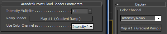

  4. If a shader is applied to the point-cloud object's color channel, such as when using the Elevation Ramp option, copy the shader from the Map button on the point-cloud object's Display rollout (command panel) to the Ramp Shader button on the Point Cloud Shader Parameters rollout in the Material Editor as an instance. An easy way to do this is simply by dragging and dropping from the command panel to the Material Editor. When the dialog opens querying Instance or Copy, make sure Instance is chosen and click OK.
    The following illustration shows the result of doing this: Map #1 (Gradient Ramp) has been copied from the Display rollout on the right to the Ramp Shader parameter on the left.
  5. Also on the Point Cloud Shader Parameters rollout, set the Use Color Channel As parameter (drop-down list) to the active option on the command panel Display rollout; for instance, Intensity Ramp.
This gives the point-cloud object a look similar to that obtained with the default material, with the added benefit of enabling the object to respond to scene lighting. Note, however, that any shadows incorporated in the original capture remain.

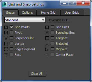

  4. On the main toolbar, click 3D Snap to turn on snapping, then right-click the same button to open the Grid And Snap Settings dialog.
    By default, the dialog opens to the Snaps panel with the Standard category active and the Grid Points option enabled.
  5. Turn off Grid Points, then click Standard and choose Point Cloud Objects from the drop-down list.
  6. In the Point Cloud Objects category, turn on the single option: Point Cloud Vertex. Close the dialog.

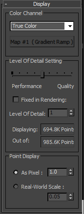

Color Channel
The method of coloring the point-cloud data in the viewports and in rendered output. Choose one of the following from the drop-down list:
  • True Color Displays the original colors in the point-cloud file. Typically these colors are relatively faithful to those in the digitized scene. This is the default Color Channel setting.
  • Elevation Ramp Applies a vertical color gradient derived from a Gradient Ramp map to the point-cloud object. The leftmost point in the gradient corresponds to the bottom of the point-cloud object while the rightmost gradient point corresponds to the top of the point-cloud object.
    To change the default grayscale gradient map, click the (Gradient Ramp) button below the drop-down list. This opens the Material/Map Browser, from which you can apply a different map, or choose the current map (under Scene Materials) to edit. You can apply any map, but only the Gradient Ramp map is meaningful in this context.
    Tip: The Elevation Ramp option can be useful for visualizing relative heights of a scanned area for analysis. For example, you can apply a gradient to a terrain to see where water will drain (highest areas) and where it will accumulate (lowest areas). Using a highly differentiated gradient makes it easier to see these areas from the top.

Level Of Detail Setting group
Performance/Quality slider
Controls the number of visible points in the cloud in the viewports. When Fixed In Rendering (see following) is off, this setting also affects the rendered output. To reduce the number of visible points and improve performance, move the slider toward the left (Performance) end of the scale. To increase the number of visible points, move the slider toward the right (Quality) end of the scale. For better-looking results at the potential cost of performance, use the right side of the scale.
The number of points currently visible and the total number of points in the object appear in the read-only fields at the bottom of the Level Of Detail Setting group: Displaying and Out Of, respectively.

Point Display
Choose how points in the cloud are displayed:
  • As Pixel Each visible point in the cloud is displayed as a single point of color, or pixel. The numeric setting serves as a multiplier for the pixel size. The greater the multiplier value, the larger the point.
  • Real-World Scale Shows and enables you to set the displayed point size in terms of the current Display Unit Scale setting.
