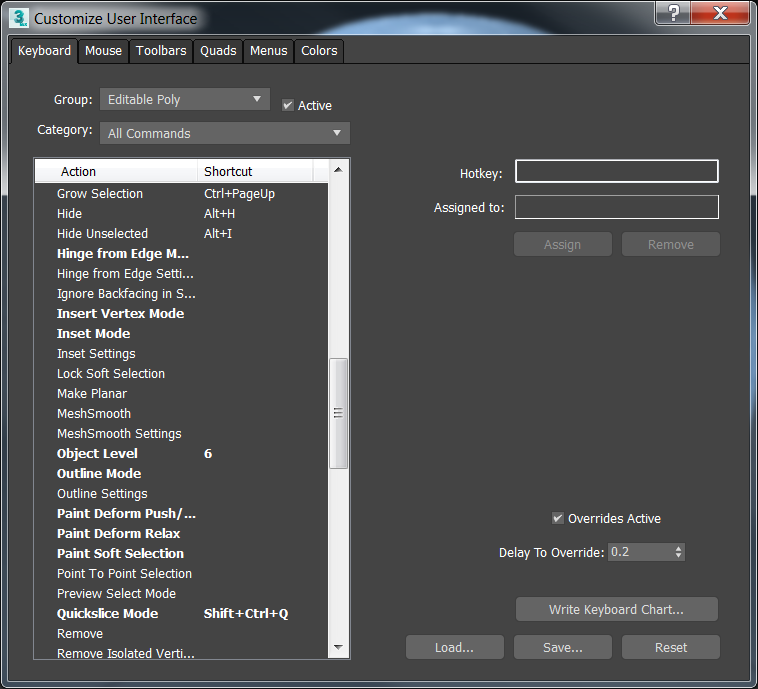

While working with poly objects, you can use a “press/release keyboard shortcut” to temporarily override the current operation and perform a different one. As soon as you release the keyboard shortcut, you return to the previous operation.
For example, you might be working at the Polygon sub-object level, moving polygons, and need to rotate the object to access a different part of it. Instead of having to exit the Polygon sub-object level, rotate the object and then re-enter the sub-object level, you could simply press and hold 6, rotate the object, release the key, and immediately return to moving polygons.
To see a list of press/release keyboard shortcuts, go to Customize Customize User Interface
Keyboard panel, open the Group drop-down list, and choose Edit Poly or Editable Poly. The actions in boldface are the ones that you can assign as press/release shortcuts. Not all are assigned; for information about assigning keyboard shortcuts, see
Keyboard Panel.
The actions in boldface can function as press/release shortcuts.
While working with poly objects, you can easily toggle between sub-object levels using a hotkey. Using a single hotkey to move between levels allows you to spend less time searching for the appropriate key or button, and more time working.
Instead of removing your focus from what you are working on to find the appropriate button to click, you can simply hover the cursor over the desired sub-object level and press the hotkey. For example, to go to the vertex sub-object level place the cursor over a vertex and press the hotkey. Likewise if you place the cursor over a polygon and press the hotkey, you will switch to the polygon sub-object level.
Using a single hotkey to change sub-object level is called Subobject Pick. To view/assign the keyboard shortcut for this action, go to Customize Customize User Interface
Keyboard panel
select Editable Poly from the Group list
Subobject Pick. For information about assigning keyboard shortcuts, see
Keyboard Panel.
