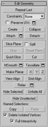

Selection rollout. This topic covers the Edit Polygons/Elements rollout and Edit Geometry rollout functions for these sub-object types; for other controls, see

For detailed descriptions of these controls, see Edit Geometry Rollout (Polymesh and Edit Poly).
