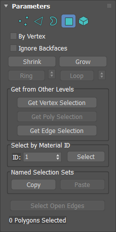

Parameters rollout
Provides buttons for accessing different sub-object levels, working with named selections and handles, display settings, and information about selected entities.
The icons at the top of the Selection rollout let you specify the method of face selection.
Clicking a button here is the same as choosing a sub-object type in the modifier stack. Click the button again to turn it off and return to the Object selection level.

Vertex
- Selects a vertex beneath the cursor; region selection selects vertices within the region.
Edge
- Selects a polygon edge beneath the cursor; region selection selects multiple edges within the region.
Border
- Turns on Border sub-object mode, which lets you select an area on a mesh that can generally be described as a
hole. Areas like this are usually sequences of edges with faces on only one side. For example, a box doesn't have a border, but the Teapot object has several of them: on the lid, on the body, on the spout, and two on the handle. If you create a cylinder, then delete the top face, the top row of edges forms a border.
When the Border sub-object level is active, you can't select edges that aren't on borders. Clicking a single edge on a border selects that whole border.
Borders can be capped (either in editable poly or by applying the cap holes modifier). They can also be connected to another object (compound object connect).
Polygon
- Selects all coplanar polygons beneath the cursor. Usually, a polygon is the area you see within the visible wire edges. Region selection selects multiple polygons within the region.
Element
- Selects all contiguous polygons in an object; region selection selects the same.
- By Vertex
- Selects any sub-objects at the current level that use a vertex you click. Applies to all sub-object levels except Vertex. Also works with Region Select.
- Ignore Backfaces
- Selecting sub-objects selects only those whose normals make them visible in the viewport. When turned off (the default), selection includes all sub-objects, regardless of the direction of their normals.

- Shrink
- Reduces the sub-object selection area by deselecting the outermost sub-objects. If the selection size can no longer be reduced, the remaining sub-objects are deselected.
- Grow
- Expands the selection area outward in all available directions.
For this function, a border is considered to be an edge selection.
With Shrink and Grow, you can add or remove neighboring elements from the edges of your current selection. This works at any sub-object level.
- Ring
- Expands an edge selection by selecting all edges parallel to the selected edges. Ring applies only to edge and border selections.
Ring selection adds to the selection all the edges that are parallel to the ones selected originally.
- Loop
- Expands the selection as far as possible, in alignment with selected edges.
Loop applies only to edge and border selections, and propagates only through four-way junctions.
Loop selection extends your current edge selection by adding all the edges aligned to the ones selected originally.
Get from Other Levels group
Applies selections from one sub-object level to another.
- Get Vertex Selection
- Selects faces based on the last vertex selection. Selects all faces shared by any selected vertex. The selection is added to the current selection. Available only when the current sub-object level is not Vertex.
- Get Poly Selection
- Selects vertices based on the last polygon/element selection. This selection is added to the current selection. Available only when the current sub-object level is not Polygon or Element.
- Get Edge Selection
- Selects faces based on the last edge selection. Selects those faces that contain the edge. Available only when the current sub-object level is not Edge or Border.
Select by Material ID group
Selects faces based on their material ID.
- ID
- Set the spinner to the ID number you want to select, and then click the Select button. Press
Ctrl while clicking to add to the current selection, or press
Alt to remove from the current selection.
Named Selection Sets group
These functions are primarily for copying
named selection setsof sub-objects between similar objects, and between comparable modifiers and editable objects. For example, you can apply a Poly Select modifier to a sphere, create a named selection set of edges, and then copy the selection to a different sphere that's been converted to an editable mesh object. You can even copy the selection set to a different type of object, because the selection is identified by the entities' ID numbers.
The standard procedure is to create a selection set, name it, and then use Copy to duplicate it into the copy buffer. Next, select a different object and/or modifier, go to the same sub-object level as you were in when you copied the set, and click Paste.
Note: Because sub-object ID numbers vary from object to object, the results of copying named selection sets between different objects can be unexpected. For example, if the buffered set contains only entities numbered higher than any that exist in the target object, no entities will be selected when the set is pasted.
- Copy
- Places a named selection into the copy buffer.
- Paste
- Pastes a named selection from the copy buffer.
- Select Open Edges
- Selects all edges with only one face. In most objects, this will show you where missing faces exist. Available only at the Edge or Border sub-object level.
- [selection info]
- At the bottom of the Parameters rollout for Mesh Select is a text display giving you information about the current selection. If 0 or more than one sub-object is selected, the text gives the number and type selected. If one sub-object is selected, the text gives the ID number and type of the selected item.
Note: When the current sub-object type is Element, selection information is given in polygons When the current sub-object type is Border, selection information is given in edges.
