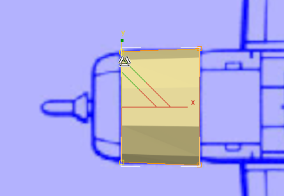

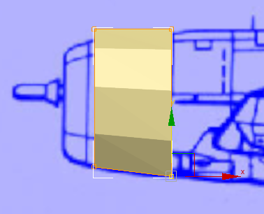

Create a cylinder to begin the engine cowl:
- On the
Create panel, activate
(Geometry), then on the Object Type rollout, click to activate Cylinder.

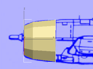

- In the Left viewport, drag from the center of the propellor hub to create a cylinder that is about as wide as the airplane. Give it a height of about 60 (the exact value is not important). Set Height Segments to 1, Sides to 10, and turn off Smooth.
Note: With 10 sides, the top and bottom segments are flat: This will come in handy when you add some details such as the tail.
- Change the name of the cylinder to P-47.
- Activate
(Select And Move). In the Left viewport, move the cylinder so it is well centered on the image of the airplane. In the Top viewport, move it forward so its rear edge coincides with the rear edge of the engine cowl.

- If you need to, reduce the height of the cylinder so its front edge matches the edge where the air-intake cover meets the cowl.
Note: In this step, as in much of this tutorial, you are using the “blueprint” images as a guide, and the exact values don’t matter much. Use your eye and your judgement.

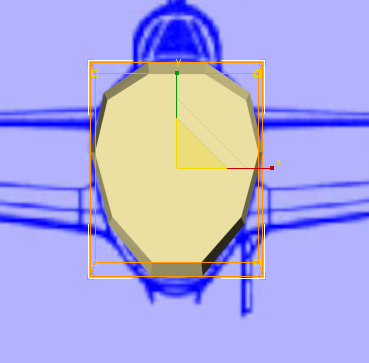

- Go to the
Modify panel, and apply an FFD 3x3x3 modifier to the cylinder. FFD stands for “free-form deformation.” This modifier lets you adjust the shape of the cylinder, using a 3x3x3 array of control points.
- On the modifier stack, click
(the plus-sign icon) to open the FFD 3x3x3 modifier hierachy. Click Control Points to highlight that sub-object level.
- In the Left viewport, drag to select the bottom row of FFD control points (this actually selects all nine control points at the bottom of the lattice), then
move them down so they coincide with the bottom of the fuselage.
Scale them along the X axis so they are a bit closer together.
- Drag to select the upper row and plane of control points.
Scale them out a bit along the X axis, then
move them up a bit along the Y axis.
You now have a good cross-section of the cowl at the front of the fuselage. In the next procedure, you refine its shape along the length of the airplane.

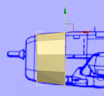

Taper the profile of the cowl:
- On the modifier stack, click the FFD 3x3x3 entry to exit the Control Points level. Then choose Modifier List
FFD 2x2x2. You will use this additional free-form deformation modifier to give some taper to the nose of the airplane.
(the plus-sign icon) to open the FFD 2x2x2 modifier hierachy. Click Control Points to highlight that sub-object level.
- In the Front viewport, drag a selection box to select the row of control points at the lower leading edge of the cowl, then
move the points to follow the taper of the image. Do the same for the lower trailing edge of the cowl.
- Do a similar adjustment for the upper profile of the cowl.

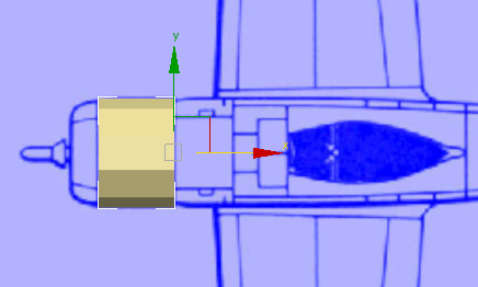

- In the Top viewport, drag to select the leading plane of control points, then
scale them down a bit along the Y axis to taper the cowl in that dimension as well. so it matches the blueprint image.
The changes you make in the Front and Top viewports also appear in the Left viewport.

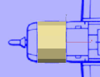

Extend the cowl forward:
- Right-click the P-47 cylinder, then from the Transform (lower-right) quadrant of the quad menu, choose Convert To
Convert To Editable Poly. By converting the cylinder to an Editable Poly object, you lose the specific Cylinder and FFD modifier controls, but you gain access to the rich set of Editable Poly sub-object controls.
- If the Graphite Modeling Tools ribbon is not displayed, then on the main toolbar, click
(Toggle Ribbon).
- If the ribbon is displayed but not fully expanded, click the
expand/minimize icon until the full ribbon is visible.
- On the ribbon
Modeling tab
Polygon Modeling panel, click
(Polygon) to go to the Polygon sub-object level.
click to select the large polygon at the front of the cowl.
- Activate the Perspective viewport.
- On the ribbon
Polygons panel, click
(Bevel).
The Bevel tool does two things: It extrudes a selection, and then lets you scale the size of the extrusion.
- Do this step in the Perspective viewport, but watch your work in the Front viewport: Drag upward to extrude the selected polygon as far as the front of the airplane.
Release the mouse, then drag downward to scale the polygon so it tapers as the blueprint image shows.
The curve of the cowl is subtler than the model we have so far, but you will fix that later on.
