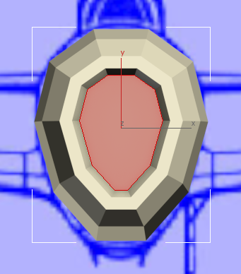

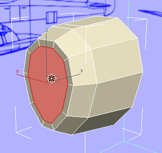

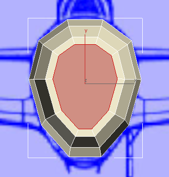

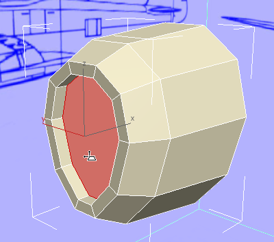

  2. With the front polygon still selected, on the ribbon Polygons panel, click (Inset). In the Perspective viewport, drag downward to reduce the size of the front polygon, and add polygons around it.
    You can also see this change in the Left viewport.
  3. On the ribbon Polygons panel, click (Bevel). In the Perspective viewport, drag downward to recess the central polygon.
    Release the mouse, then drag it downward again a little bit, to taper the inside of the recess. This change is easier to see in the Left viewport.
    As for most of the P-47 model, exact distances don’t matter here: The important thing is the overall look.

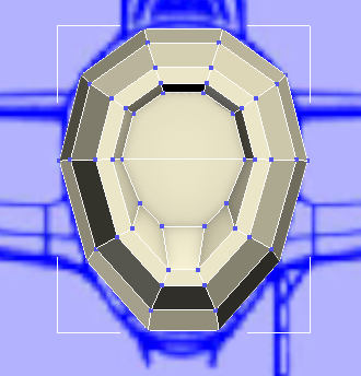

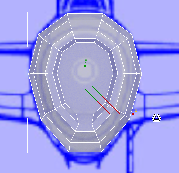

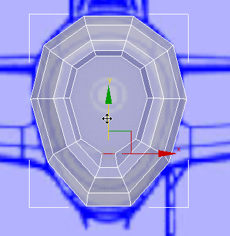

  5. On the ribbon Polygon Modeling panel, click (Edge) to go to the Edge sub-object level. Click to select the center edge at the bottom of the recess.

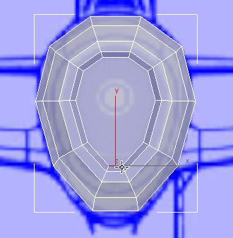

  6. Move the edge up until it is just below the circular border.
  7. Scale the edge out a bit along the X axis so the outline of the intake becomes a bit rounder.

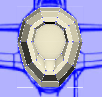

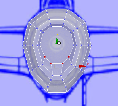

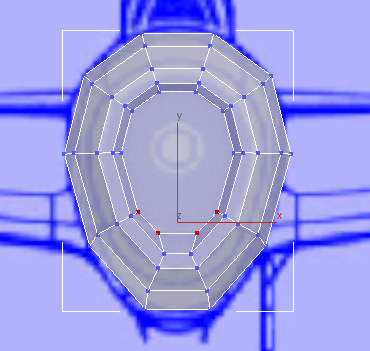

  8. On the ribbon Polygon Modeling panel, click (Vertex) to go to the Vertex sub-object level. Click and Ctrl+click to select the four vertices at the lower edge of the inner portion of the recess.
    Tip: If you select a vertex you don’t want, Alt+click to deselect it.
  9. Move the vertices up along the Y axis to make the cooling intake even more rounded.

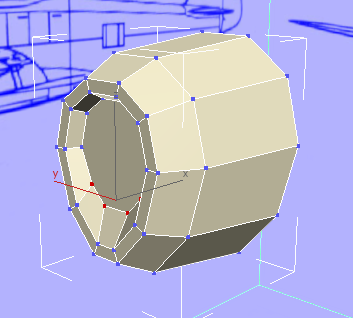

    If you activate the Perspective viewport and press Alt+X to turn off X-Ray display, you can get a better view of the work you’ve just done.

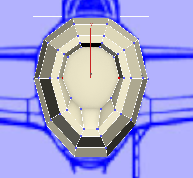

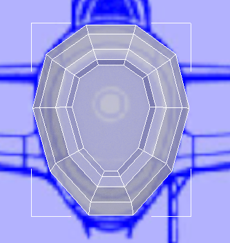

  1. Activate the Left viewport again. Zoom in a bit so the geometry is easier to see.
  2. Click and Ctrl+click to select the two vertices at either side of the intake polygon.
  3. On the ribbon Loops panel, click (Connect).
    It is hard to see the connecting edge until you click elsewhere in the viewport to deselect the initial vertices.
  4. Use the method from the previous two steps to add two more horizontal edges: one above the center edge, and one below it.
    Now the original 10-sided polygon is divided into four polygons, and each of the new polygons has only four sides.
