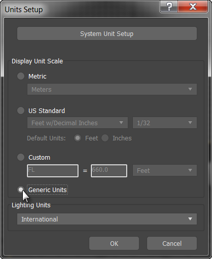

Display Unit Scale group, make sure Generic Units is chosen.

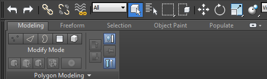

By default, when you start 3ds Max, a minimized version of the ribbon displays directly below the main toolbar.
If you don't see the ribbon, then on the main toolbar, click
(Toggle Ribbon).

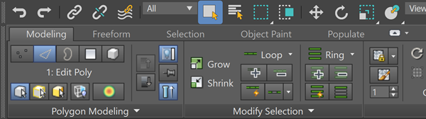

Most of the ribbon tools are inactive, since no editable polygon object is selected in the scene.
The selected object is now an editable poly, so the ribbon updates to display a range of polygon-editing tools.

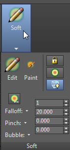

Use Soft Selection to shape the helmet:
Polygon Modeling panel, click
When Soft Selection is active, 3ds Max displays the Soft Selection controls on a temporary panel named "Soft" to the right of the existing ribbon controls. If there's not enough room on the ribbon for all of the controls, the panel shows only its title, and you need to click the panel to open its controls.
