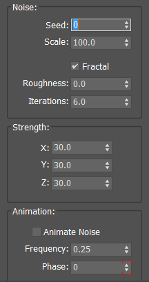

  4. Click the Modifier List drop-down menu and choose the Noise modifier.
  5. In the Noise group, turn on Fractal, and in the Strength group, set X, Y, and Z to 30.0.
    The rock is taking shape, but it could be flatter.
  6. On the main toolbar, click to activate (Select and Uniform Scale).
  7. In the Camera001 view, drag the gizmo Z axis downward until the rock object is about two-thirds its original height.

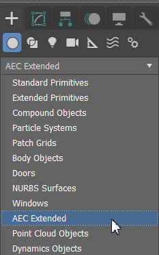

  1. On the Create panel, activate (Geometry), then from the drop-down list (at present, it shows “Standard Primitives”), choose AEC Extended.
    AEC Extended objects are pre-built geometry, including railings, fences, and plants. They are a fast way to add realistic details to a scene.

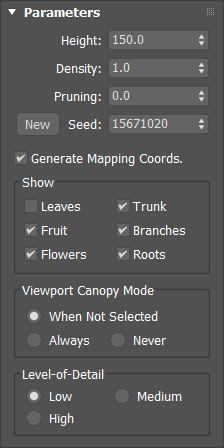

  5. With the tree still selected, on the Parameters rollout, set Height to 150.
  6. In the Show group, turn off Leaves, and in the Level-Of-Detail group, choose Low to reduce the number of branches.
  7. If you are not yet satisfied with the appearance of the tree, on the Parameters rollout click New.
    Each time you click this button, the Seed value is changed, causing the tree to undergo a random reconfiguration.
