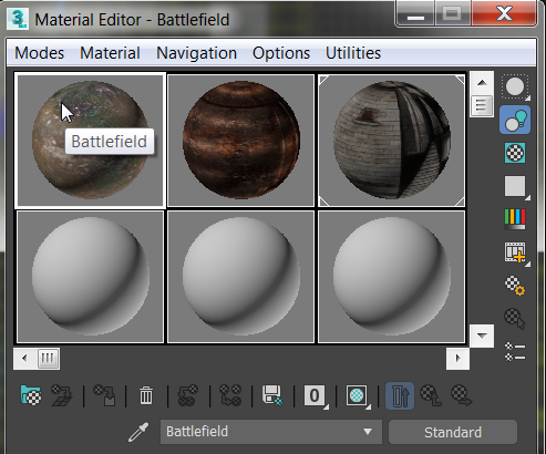

    By default, the Compact Material Editor shows six sample slots, each of which is capable of holding a material. Typically, you would have multiple materials to choose from, so you might prefer to expand the number of sample slots selectable from the editor.
  2. Locate the Battlefield material sample slot and click it.
    Notice that the name Battlefield appears in the Material Name field below the sample slots.
    This material has already been constructed for you. It uses a bitmap as a texture and includes a bump map.

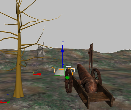

  3. Drag the Battlefield material from its sample slot and drop it onto the Field object in the Camera001 viewport.
    The viewport now displays a landscape covered by grass and dirt.
    Tip: If the material doesn't appear in the viewport, click to turn on (Show Shaded Material In Viewport). This button is in the row of buttons just below the sample slots.

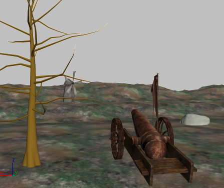

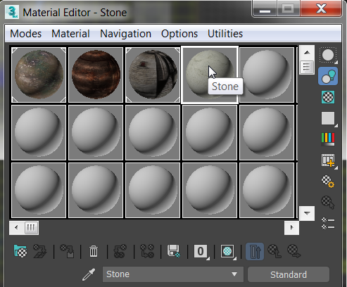

  4. Select the rock object in the viewport, and then drag the Stone material from its sample slot onto the rock object. The stone surface updates to a realistic texture.
    If at first you can't see the sample slot for the Stone material, right-click one of the sample slots and choose 5 X 3 Sample Windows to display more of the slots.

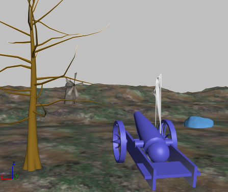

    All parts of the cannon were previously grouped together into a single entity, called a selection set. This way, when you choose a material, it is applied to all components in the selection set in a single action.
  1. From the main menu Named Selection Sets drop-down list, choose Cannon.
    Notice that the cannon is now selected in each viewport.
