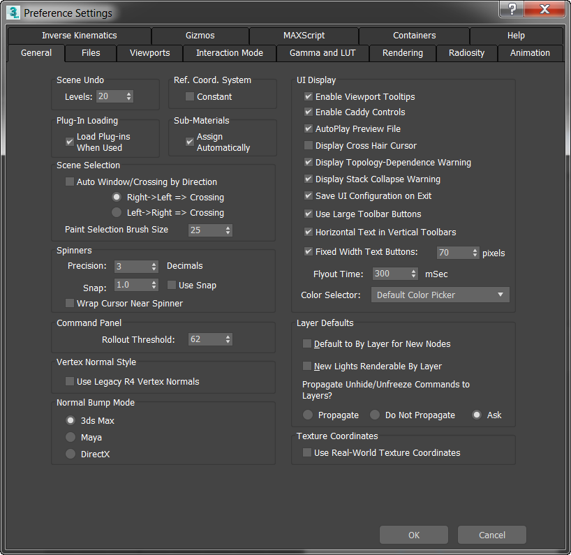

Make sure Use Real-World Texture Coordinates is turned off:
- From the main toolbar, choose Customize
Preferences.
- On the Preference Settings dialog, go to the General tab.
- In the Texture Coordinates group, make sure Use Real-World Texture Coordinates is off, then click OK.
The dimensions of the scene will actually be close to the real-world dimensions, but
3ds Max doesn’t need to enforce that: This option would just add complications to your work.

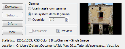

View the reference/texture bitmap, and note its dimensions:
- On the main menu, choose Rendering
View Image File. In the View File dialog, navigate to the
\sceneassets\images
folder, and highlight
fac1.jpg.
In the lower-left corner of the View File dialog, a status line shows the dimensions of the image, which are 1200 x 1533 pixels. This will become the aspect ratio of the façade.
- Click Open to view the image at full size.

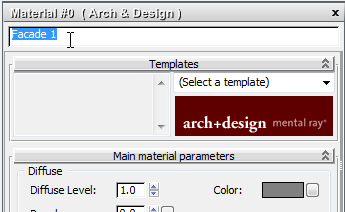

- Double-click the Arch & Design material node to display the material parameters in the Parameter Editor panel on the right.
- Name the material
Facade 1.
- On the Templates rollout, choose Matte Finish from the drop-down list of templates.

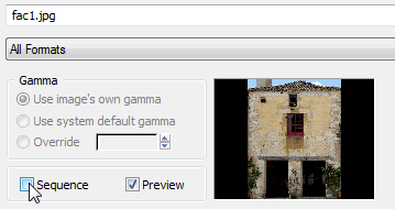

- On the file dialog, choose
fac1.jpg,
turn off Sequence, and then click Open.
Important: In the Select Bitmap Image File dialog, be sure to turn off the Sequence toggle.
When Sequence is on,
3ds Max attempts to create an IFL animation, and you should open only the single image.

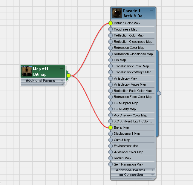

3ds Max adds a Bitmap node to the active View.

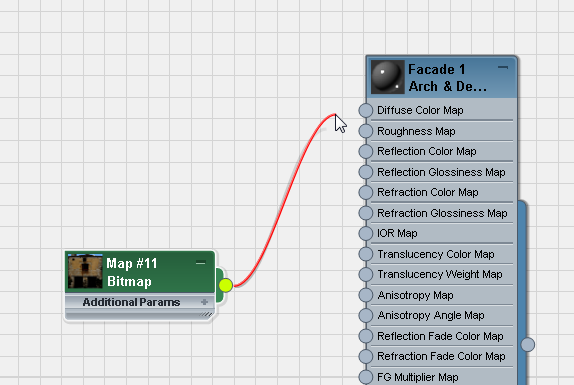

- Drag from the Bitmap node’s output socket (the small circle at the right). A wire appears in the View. Drop the end of the wire on the Arch & Design material’s Diffuse Color Map input socket (the small circle at the left).
- Drag from the Bitmap node’s output socket again, and this time connect the wire to the Arch & Design material’s Bump Map component.
