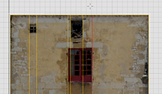

  3. Drag over the façade near the top edge. 3ds Max constructs a vertical edge, which you can move.
  4. Click to set a vertical loop at the left edge of the small window in the upper left of the façade.
  5. Add additional vertical loops for the other window edges.
  6. Add horizontal loops to define the tops and bottoms of the windows.

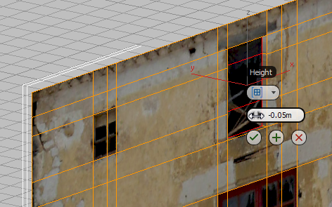

  7. On the ribbon, click (Polygon) to go to the Polygon sub-object level.
  8. Click and Ctrl+click to select the three faces of the top center window.
  9. On the ribbon Polygons panel, click the drop-down arrow next to the Extrude button, and choose Extrude Settings.
    3ds Max displays an interactive manipulator called a “caddy.”
  10. Drag the arrows by the Height control, and extrude the window back by about –0.05m.
    Tip: You can also simply type –0.05 in the Height field, and then press Enter.
  11. Click (OK: the check-mark icon at the bottom of the caddy) to complete the extrusion.

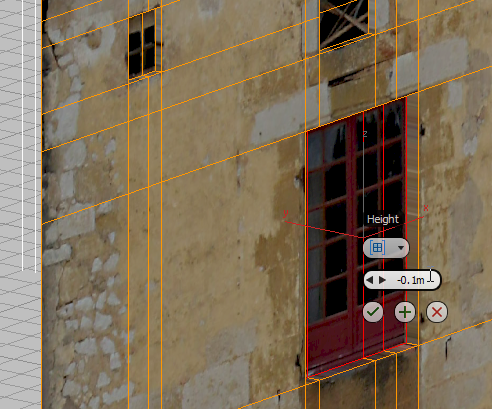

  4. Click and Ctrl+click to select the four polygons of the main window in the center of the wall.
  5. On the ribbon, Shift+click (Extrude).
  6. This window should have more depth than the smaller windows, so in the Height field, enter –0.1m, then press Enter.
  7. On the caddy, click (OK).
