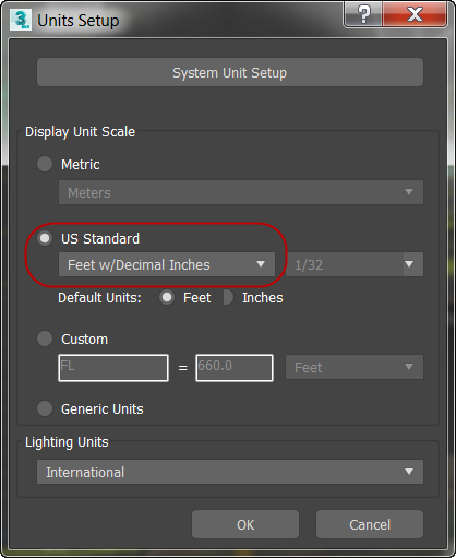

- On the menu bar, choose Customize
Units Setup.
The Units Setup dialog appears.
- In the Display Unit Scale group, choose US Standard, if necessary.
Set the scale to Feet w/Decimal inches, if necessary.
Note: Leave the System Unit Setup as it is. This should be changed only to reset the system unit to the default setting (inches) after loading a file that uses a different system unit, or if you are working on files that are so huge or so tiny that values don't appear correctly in the numeric entry fields.
- Click OK to accept the change.

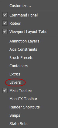

- By default, the Layers toolbar is hidden when you start
3ds Max. If it is not currently open, right-click a blank space on the main toolbar and choose Layers from the pop-up menu.

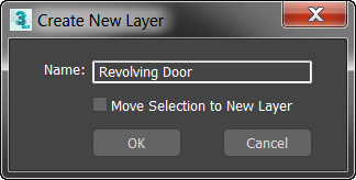

- On the Layers toolbar, click
(Create New Layer).
This creates a new layer and opens the Create New Layer dialog.
- Use the Create New Layer dialog to name the Layer
Revolving Door, and then click OK.

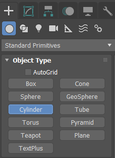

- On the
Create panel, activate
(Geometry). Make sure Standard Primitives is chosen in the drop-down list, then on the Object Type rollout, click to activate Cylinder.
The Cylinder button highlights to indicate it is active and ready for use.

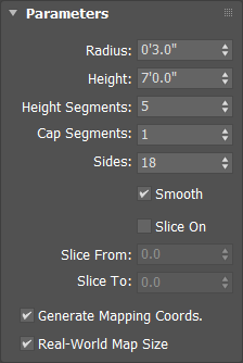

- On the Parameters rollout change the Radius value to
0' 3.0", then change the Height to
7' 0.0".

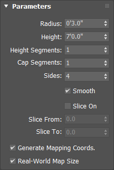

- On the Parameters rollout, change Height Segments to
1, then change Sides to
4.
Tip: The lowest possible Height Segments value is 1. You can minimize the value of a numeric field by right-clicking the spinner arrows to the right of the field where you can type.
The Cylinder changes into a tall box with four sides; this will make it easier to create the door. Later you'll change the pole back to a cylinder.
