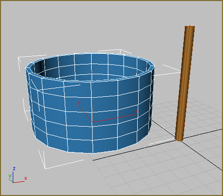

Create the tube:
- On the navigation controls, click
(Zoom Extents) to zoom back so you can see the area around the cylinder.

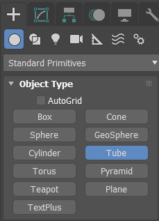

- On the
Create panel
Object Type rollout, click to activate Tube.
The Tube button highlights, indicating it is active and ready for use.
- Drag out a tube anywhere in the viewport.
The size doesn't matter; you'll be changing it in a moment.
Make a tube.

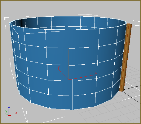

- In the Parameters rollout on the Create panel, change Radius 1 to 6' 0.0". You may need to click
Modify to display the Parameters rollout.
- Change Radius 2 to
5' 11.0"
- Change Height to
7' 0.0".
Change the radius and height of the tube.
- If necessary, zoom out so you can see both the tube and the cylinder.

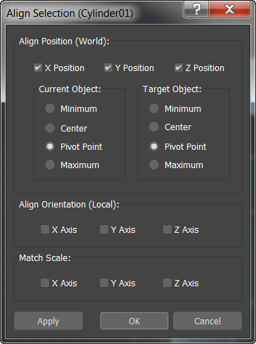

Align the tube:
Next, you'll center the tube over the cylinder.
- On the toolbar, click
Align.
The tube is already selected, so you'll align it to the cylinder.
- Click the cylinder in the viewport.
- In the Align Selection (Cylinder01) dialog
Align Position (World) group, turn on X Position, Y Position, and Z Position. Choose Pivot Point for both Current Object and Target Object. Click OK.
The tube is centered over the cylinder.

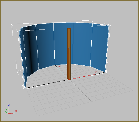

Slice the tube:
- Go to the
Modify panel.
- On the Parameters rollout, turn on Slice On.
- Adjust the Slice From and Slice To values so you have a half of a tube visible in the viewport, resembling the illustration. Set them to
90.0 and
–90.0 degrees.
Slice the tube
- Change Sides to
6. The enclosure will be created out of flat panels, rather than curved glass.
- Change Height Segments to
1.
Reduce the number of faces.

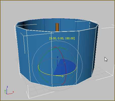

Next you'll clone the tube to create the other side of the enclosure.
Clone the tube:
- On the main toolbar, click to activate
(Select And Rotate).
- On the keyboard, press
A to turn on Angle Snap.
- Hold down the
Shift key and rotate the left enclosure 180 degrees about the Z axis.
A copy of the tube rotates into place on the other side of the enclosure.
- When the copy of the tube is in the proper position, release the mouse button.
3ds Max opens the Clone Options dialog.
- On the dialog, set the Object option to Copy and name the clone
right enclosure panels. Click OK.
(Select Object) to deactivate Select And Rotate.
- Adjust the Slice values so the tube resembles the illustration below. Set Slice From =
45 and Slice To =
–45.0.
- Change the Sides value to
3.
Left and right enclosures
You'll do some more work on the enclosures in a while, but first you'll construct the revolving door.
