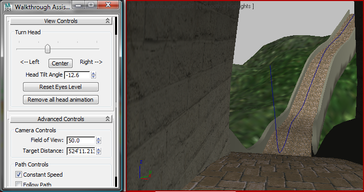

This is the same scene from the previous lesson. The camera is now in place, but you will use Walkthrough Assistant to animate the Turn Head parameters.
Turn off Follow Path:
- If the Walkthrough Assistant dialog is not visible, go to the Animation menu and choose Walkthrough Assistant.
- In the Advanced Controls rollout, in the Path Controls group, disable the Follow Path option. You will not need it because you will control the head rotation manually.
Note: Disabling the Follow Path option resets the camera orientation to its default value (positive Y). You will fix that as you start animating the head rotation from the Walkthrough Assistant dialog.
- Make sure you are at the first frame, then turn on
- In the View Controls rollout, move the Turn Head slider to the left and adjust the Head Tilt Angle to 16.4 in order get a better viewing angle of the brick path in the Camera viewport.
- Drag the time slider to frame 206. You are now at the other side of the hilltop. Adjust the Head Tilt Angle to –3.3 to level the camera head, then slide the Turn Head slider to the right to adjust the rotation.

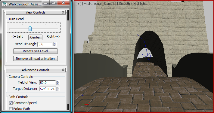

- Drag the time slider to frame 800. Change the Head Tilt Angle to 5.6. Move the Turn Head slider to the right until the tower opening is centered in the camera view.

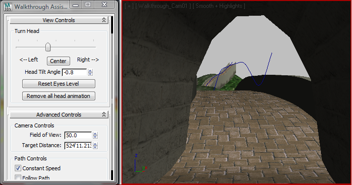

- Scrub the time slider to frame 1050. Change the Head Tilt Angle to –0.8. Move the Turn Head slider a little to the left so that the camera is tilted in anticipation of turning left after exiting the tower.

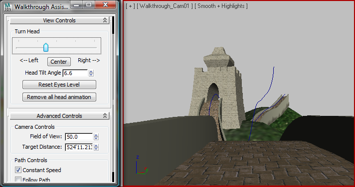

- Drag the time slider to frame 1150. Change the Head Tilt Angle to 6.6. Move the Turn Head slider slightly to the left so that you're looking the second tower in the distance.

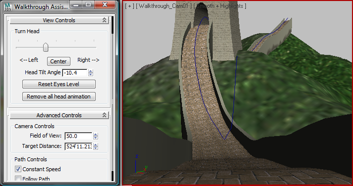

- Drag the time slider to frame 1280. This time change the Head Tilt Angle to –10.4 so that the camera head is tilted downwards to match the slope of the path.

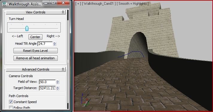

- Drag the time slider to frame 1680. You're now looking up again towards the tower ahead of you. Adjust the Head Tilt Angle to 24.7. Slide the Turn Head slider a little to the left so that is aimed at the second tower.

- Drag the time slider to frame 2030. Change the Head Tilt Angle to –12.6.

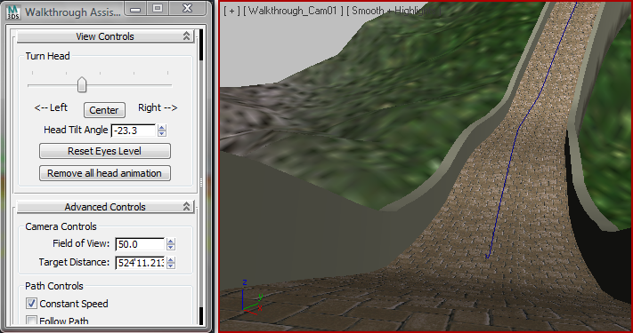

- Drag the time slider to frame 2125. At this point in the walkthrough, you are going downhill again. Change the Head Tilt Angle to about –23.3. You want the camera head tilted downward toward the path instead of out toward the scenery, because you want the animation to feel as if you're watching your step.

Play the animation in the camera viewport to see the results. Notice that the camera motion is far more natural than it was in the previous lesson. Note: The camera path will not be visible when you render the animation.
