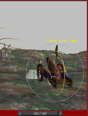

  4. On the main toolbar, click to activate (Select And Rotate).
  5. In the Camera viewport, rotate the barrel on its X axis by –10 degrees.
    As you modify the barrel rotation, the axis values update in yellow.
