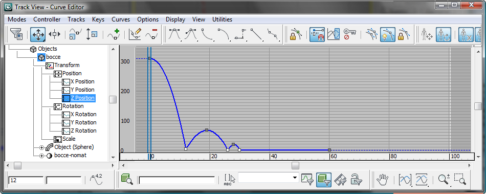

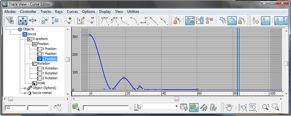

Here is the graph of a bocce ball dropped onto a hard, smooth floor from a height of just over 25 feet (7.6 meters):
As the graph shows, the ball bounces only twice, and does not have much forward momentum, either.

As with the basketball, the keys where the ball strikes the floor are not crisp enough, yet.
The three Z Position floor keys selected
The Z Position bounce keys corrected

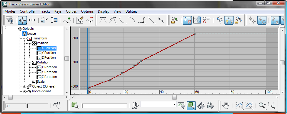

X Position rolling keys corrected
Trajectory of the bocce ball after adjusting the keys
The keys you created give a convincing animation of a heavy, solid ball.

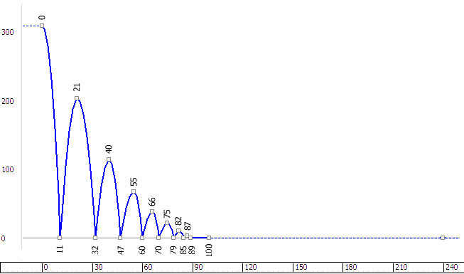

As you might expect, a tennis ball bounces more often than a bocce ball, and travels farther while it does so.
A tennis ball is hollow rubber, coated with felt. The standard weight of a tennis ball is 22 ounces (624 grams).
In this section, we won’t make you enter keyframes by hand again. Instead, we demonstrate a shortcut way to model the diminishing energy and magnitute of bounces: This is a technique that you could apply to an out-of-range, repetitious bounce such as you created for the basketball in the previous lessons.
Open the starting scene:

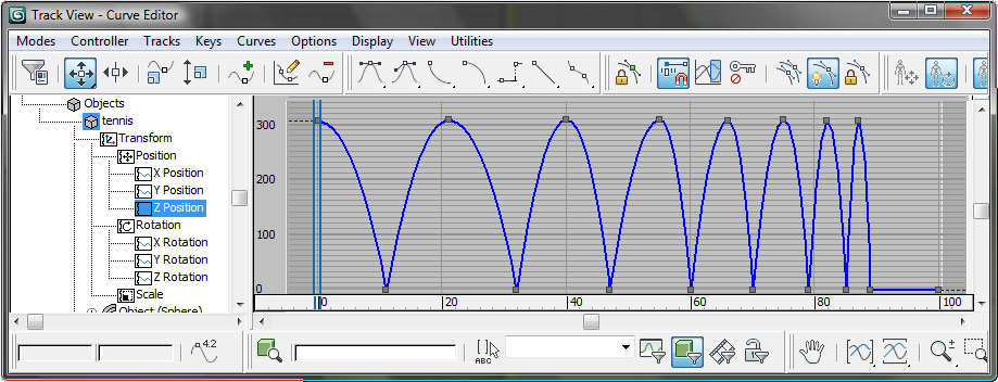

The scene contains a tennis ball and a plane that will act as the floor. The ball is animated, but it keeps bouncing back to approximately the same height: the scene doesn’t yet model a normal loss of energy. (As the ball travels, its bounces do grow closer together: The spacing of the keyframes is based on the real-world chart shown above, but the height of the bounces isn’t adjusted, yet.)

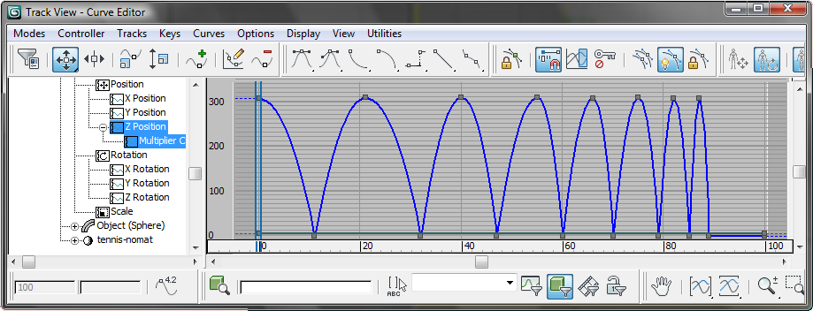

Adjust the Z Position curve by using a multiplier curve:

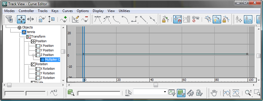

controller window, click the Z Position track to display this curve in the curve window.
Apply Multiplier Curve.
3ds Max adds a multiplier curve to the Z Position track. It also changes the curve window display so all curves are visible.
As you can see, the default value of the multiplier curve is completely flat.

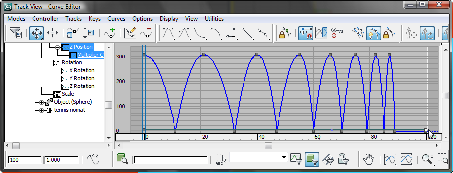

This key is close to the final key for the tennis ball itself, but is slightly above it, overlapping.

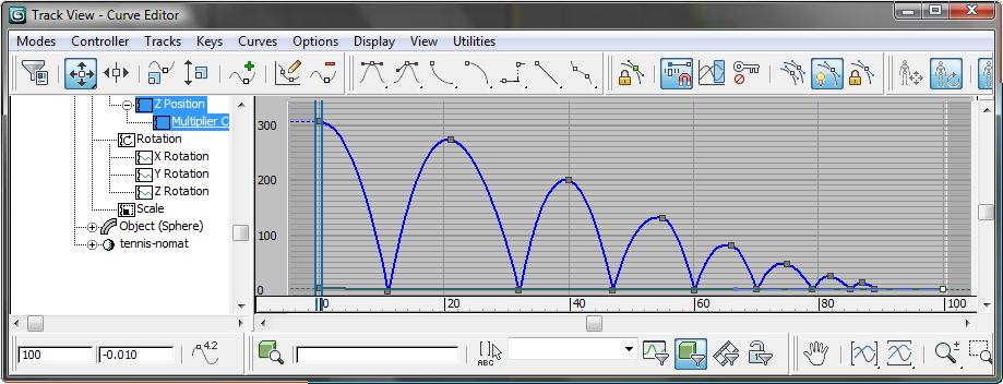

The Key Stats toolbar is the status bar at the lower left of the Curve Editor. The first field shows the current frame number, and the second field is the key value. In this field, initially set to 1.000, enter –0.01.
Now the multiplier curve “damps” the bounce of the tennis ball, simulating the loss of energy as it travels and strikes the floor.
Are the new values realistic? Comparing the results obtained from the multiplier curve with the chart for an actual tennis ball, it appears that in real life, the tennis ball loses energy, and bounce height, even more quickly than our simulation. If realism is a concern, consider keyframing each bounce, as you did for the bocce ball. But if your main concern is creating a general impression, then the multiplier curve is a useful shortcut.
