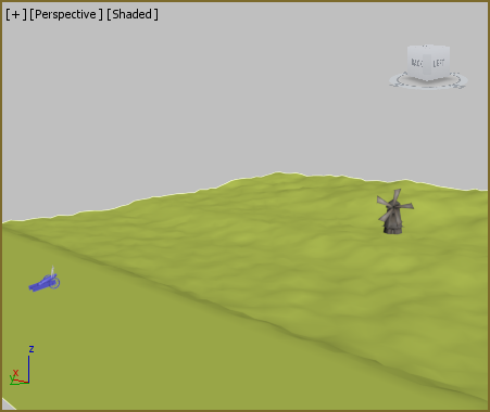

    Perspective viewport
    The Perspective viewport should be active, indicated by a yellow border. If no border is visible, right-click anywhere within the viewport to activate it.
Navigating with the ViewCube:

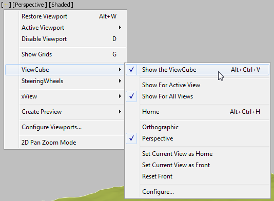

  1. Depending on how 3ds Max is currently set up, the ViewCube controls might be visible in the upper-right corners of the viewports.
    Perspective version of the ViewCube
  2. If the ViewCube is not visible, click the Perspective viewport's General label—which looks like "[ + ]"—and choose ViewCube Show the ViewCube.

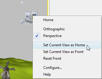

  3. In the Perspective viewport, right-click the ViewCube and choose Set Current View As Home.
  4. Click the Left face of the ViewCube to view the scene from the left.
    As you can see, the ViewCube lets you view the scene from alternative viewpoints with a simple click of a mouse.
  5. In the Perspective viewport, click the Home icon to the upper left of the ViewCube.
    The Perspective viewport returns to its initial viewpoint.
    Note: You can reset the Home viewpoint to the current view at any time by right-clicking the ViewCube and choosing Set Current View As Home.

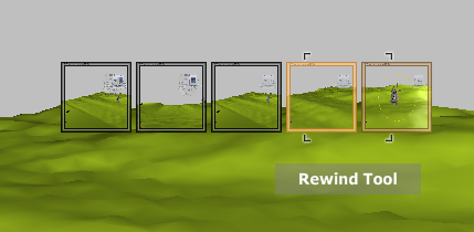

  3. When you’re done, click the Rewind button and drag to the left.
  4. The Rewind tool passes over a strip of thumbnails, each of which represents a previously selected navigation point. Release the mouse on any thumbnail. The viewport rewinds to that point.

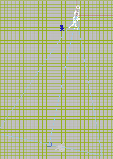

  1. Right-click the Top viewport to activate it.
    The viewport outline highlights.
  2. On the Create panel, activate (Cameras), then click to activate Target.
  3. In the Top viewport, click behind and slightly to the right of the cannon, then drag down to a point just left of the windmill (as shown in the following illustration). Don’t worry about the exact camera placement yet: You will adjust this later.

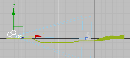

  5. On the main toolbar, click to activate (Select And Move).
    A tripod of red, blue, and green arrows appears in the Top viewport. This is the transform gizmo. As you move your cursor over the arrows, each axis label and arrow stem turn yellow. When one is yellow, you can click and drag to move the object in a single direction. If you move your cursor over the inner corners of the transform gizmo, the plane turns yellow. This lets you move in a single plane.

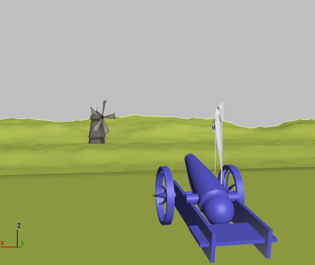

  6. Right-click the Left viewport, click the camera’s Y axis manipulator, and drag it slightly upward so you can see more of the horizon in the Camera001 viewport.
  7. If the cannon is not visible in the Camera001 viewport, then in the Top viewport drag the camera until the front of the cannon comes into view in the Camera001 viewport, as shown below.
