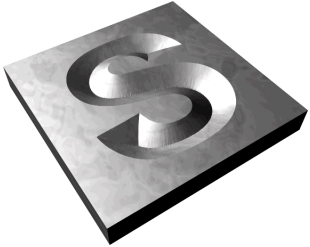

Use a V-bit carving toolpath to replicate a hand-carved look for your selected vector artwork. This toolpath enables you to control the depth of the centreline carved into the block of material, and control the order in which the toolpath segments are machined.
