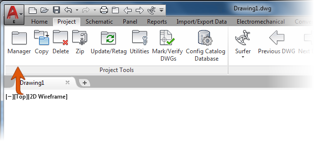

Project Manager is the tool provided to work with projects and the drawings included in a project. Find
Project Manager is a palette which allows it to remain on the screen even while you use other commands. It can be docked, resized, and set to auto-hide.

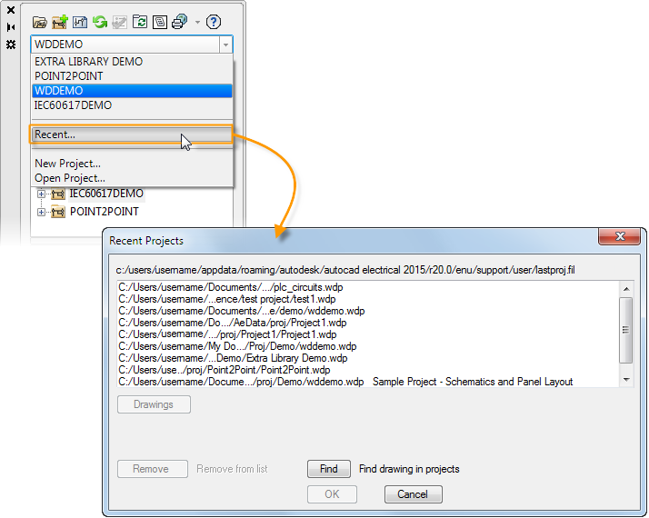

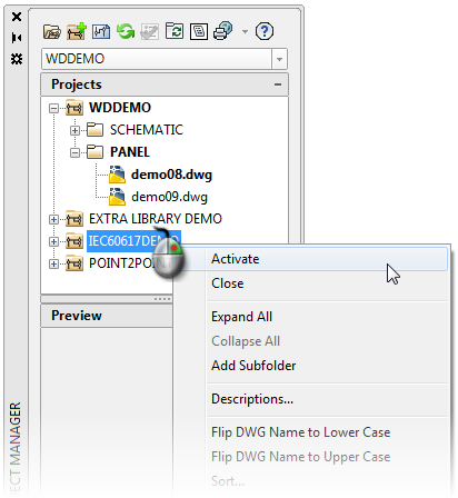

You can have as many projects open in Project Manager as you wish, but only one project can be active at a time. Project-wide functions process drawings from the active project only.

Properties that are saved in the project file as project settings. These properties do not have corresponding drawing properties and control the functionality for the entire project. There are a few ways to activate a project.
The open project is added to the list of projects in Project Manager and it becomes the active project.
