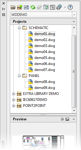

Use Project Manager to create and add drawings to a project. Find
The drawing order determines the process order when project-wide functions are used. You can drag and drop within a project to reorder the drawings. You can also add folders within a project to organize drawings.
Note: The folder structure is saved in the project file (.WDP) and does not affect the actual location of the drawings.

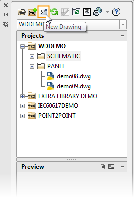

Create a Drawing
Use the New Drawing tool to create a drawing. Creating a drawing in Project Manager adds it to the active project. It is added at the end of the drawing list. Drag and drop it to change the order.

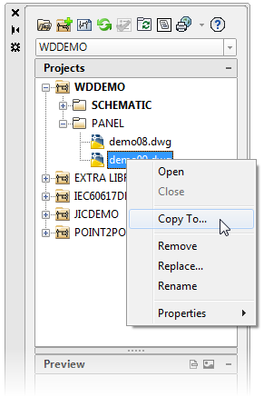

Copy a Drawing
Use Project Manager to copy a single drawing from any open project and add it to the active project.

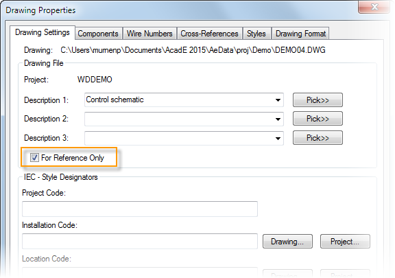

Reference Only Drawings
You may have drawings that are part of the project but you don't want them processed during project-wide functions. Or perhaps they are not even electrical drawings but they are necessary for the entire design. You can set these drawings as reference only in the drawing properties.
Tagging, cross-referencing, and reporting functions ignore reference only drawings. However, you can select to include them in project-wide plotting and title block updates.

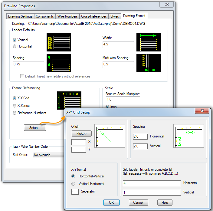

Reference System
Each schematic drawing can have a reference system defined; ladders, X-Y Grid, or X Zones. The reference system is used to assign unique schematic component tags and unique wire numbers (if not using sequential tagging). The reference system is also used for cross-referencing which we cover later.
Select your reference system in Drawing Properties Drawing Format tab Format Referencing section. Use the Setup button to define the specifics for the referencing type you choose.

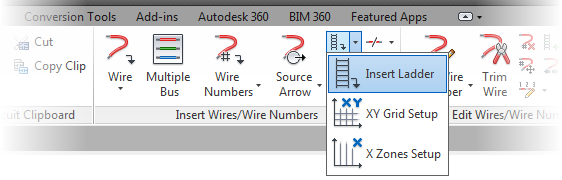

Once the reference system format is defined you can insert the ladder, X-Y Grid, or X Zones on a drawing. Find the commands on the Schematic tab Insert Wires/Wire Numbers panel.
To save time, you can define and insert the reference system on a template drawing.
