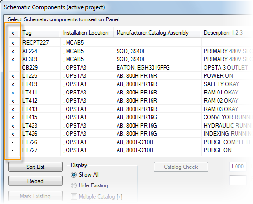

Insert from Schematic List
If you create your schematic drawings first, create your panel layouts by selecting from a list of schematic components. Find
AutoCAD Electrical uses the catalog assignment on the schematic component to find the correct panel footprint.
If a footprint symbol is not found, you can browse to a symbol or draw one on the fly. AutoCAD Electrical adds any intelligence needed so it is recognized as a panel symbol. This practice allows you to download panel symbols from vendors and use them in AutoCAD Electrical.
The dialog box indicates which schematic components are already inserted on a panel layout.
All values from the schematic component are brought over to the panel footprint. Later, if you change one of them, the other updates.
Note: Catalog values are mapped to specific footprint symbols in the Footprint Lookup database. You can edit the Footprint Lookup database using the editor provided. Find

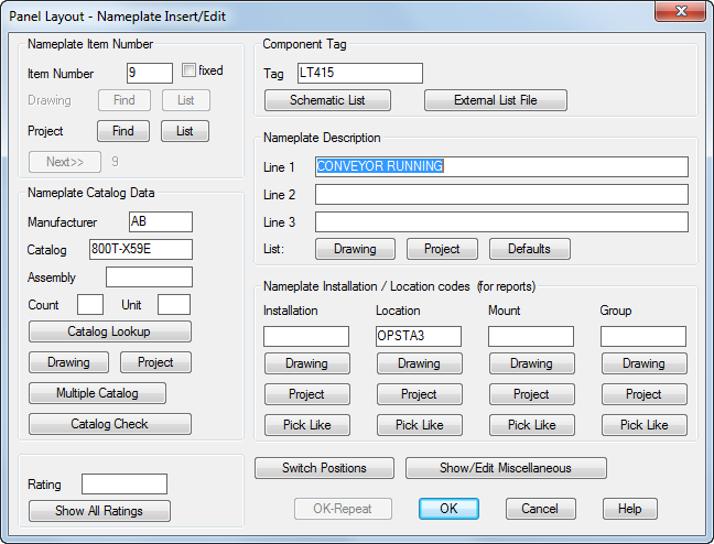

Nameplates
Use the panel icon menu to insert a nameplate.
When inserting a nameplate you can associate it to a panel footprint. Values from the footprint, such as Tag, installation, location, and descriptions, are copied from the footprint. However, you can assign an item number and catalog value specific for the nameplate.

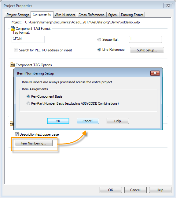

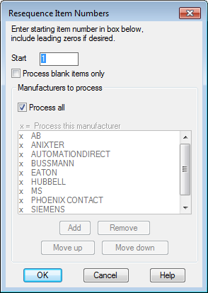

Item numbers can be assigned to both panel and schematic symbols. When you assign a catalog value to a component, the program checks if an item number is assigned to this catalog value on another component. If it is, the item number is assigned automatically. If the item number is not assigned automatically, you can assign it when you edit the component. You can also assign them project wide with the Resequence Item Numbers command. Find
The panel components are processed first, followed by the schematic components. Components with the same catalog assignment receive the same item number.
There are a couple of project properties that affect item numbering. Make sure you set these properties according to your preferences before resequencing the item numbers.

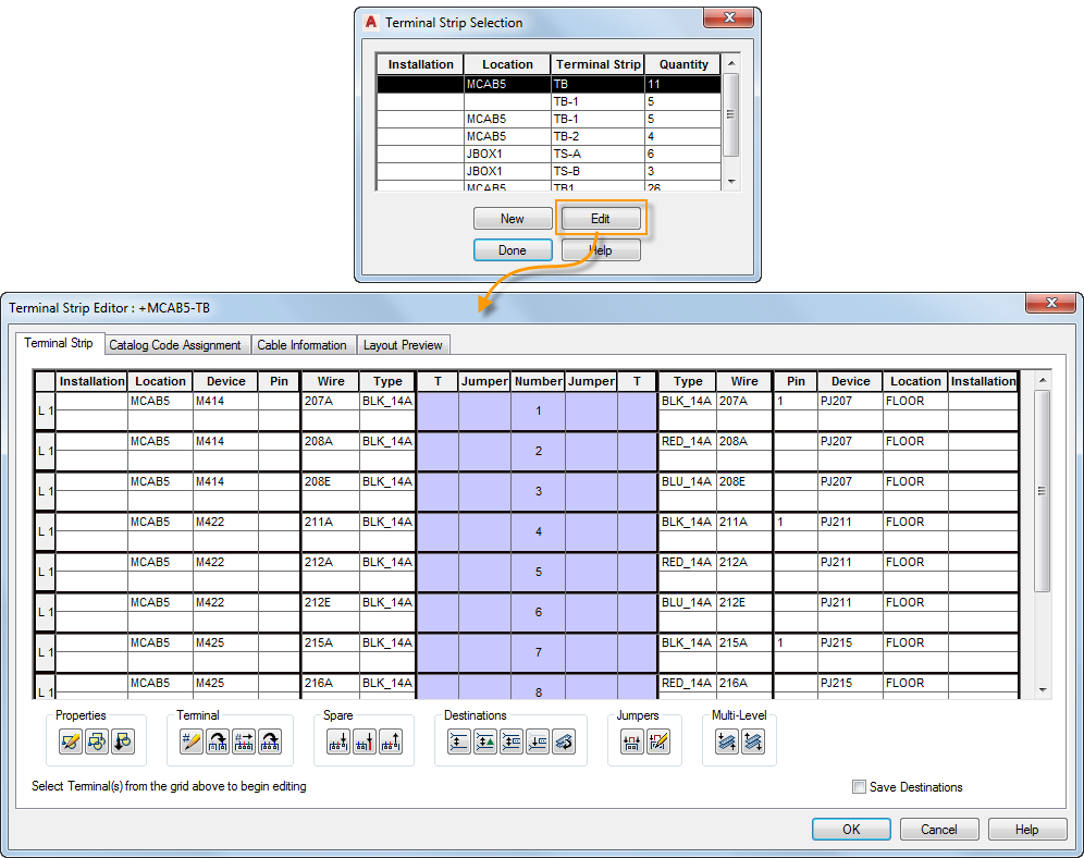

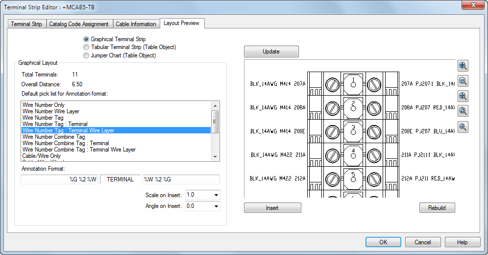

Terminal Strip Editor
The Terminal Strip Editor lets you manage entire terminal strips rather than one terminal at a time. Find
The editor includes information about catalog values, connected components, connected wires, wire numbers, and more.
Use Terminal Strip Editor to:
The list of terminals shown in a strip includes panel terminals inserted by Terminal Strip Editor and schematic terminals. If a terminal has both a schematic representation and a panel terminal inserted by the editor, it is only shown once in the editor. Any changes made are applied to both representations.
Use the Layout Preview tab to insert the terminal strip; selecting the type and annotation style. Use the preview to make sure that everything is set up the way you want.

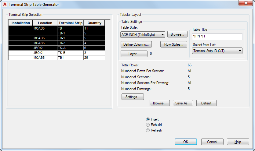

If you want to insert tabular terminal strips for one or more strips you can also use the Terminal Strip Table Generator. Find
