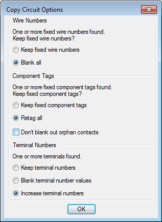

If you want to copy components and wires on the same drawing you can use the Copy Circuit command. Find
You can pick multiple insertion points to make multiple copies. Component tags update so they are unique. You can choose to update terminal numbers.

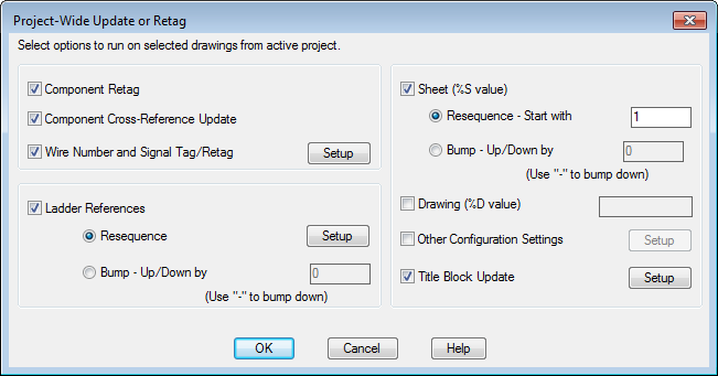

If you have a design that is similar to a previous one, you can copy and use those drawings in a new project. You probably will need to update the referencing system, retag components, reassign wire numbers, and more.
Use the Update/Retag command to update all this with one command. Find

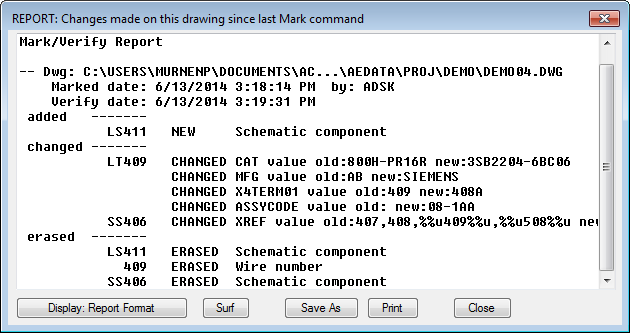

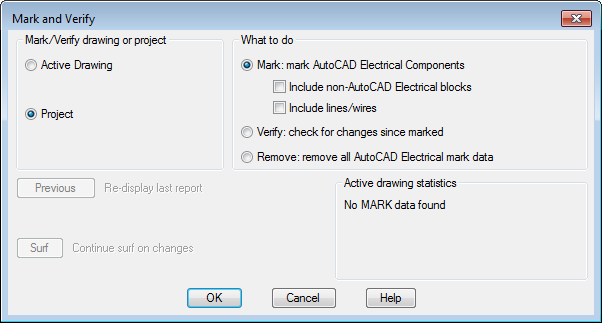

If you want to track changes that are made to your drawings, use the Mark\Verify command. Find
This command can track changes even if they are not made in AutoCAD Electrical. Use the Mark option to create a starting point. AutoCAD Electrical adds some invisible intelligence to each drawing and component.
When you want to see what changes were made after that point, run the same command and pick the Verify option. A report of all changes displays which you can print or use to surf to changed objects.
