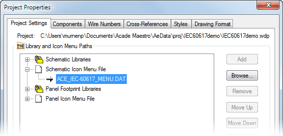

Use the Project Settings tab on the Project Properties dialog box to define the path for which set of library symbols you want to use for a particular project.

There are different icon menus for the different library sets. Use the Project Settings tab on the Project Properties dialog box to define the icon menu you want to use for a particular project.

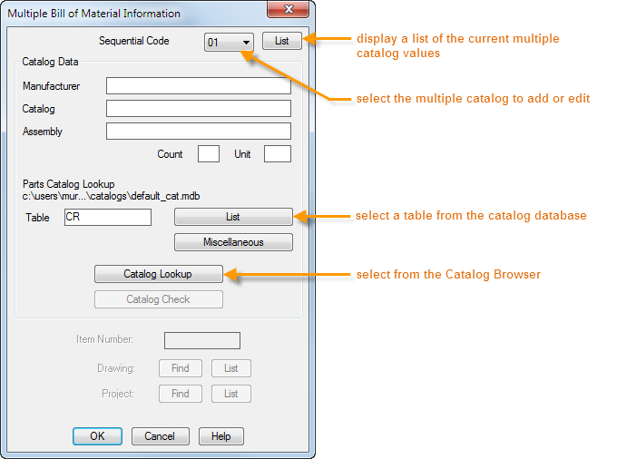

Each symbol can have a main catalog value and a number of what AutoCAD Electrical calls "multiple catalog" values. Edit a component to add, edit, or remove catalog assignments.
Click Lookup to update the main catalog value.
Click Multiple Catalog to add, change, or remove extra catalog values for the component.

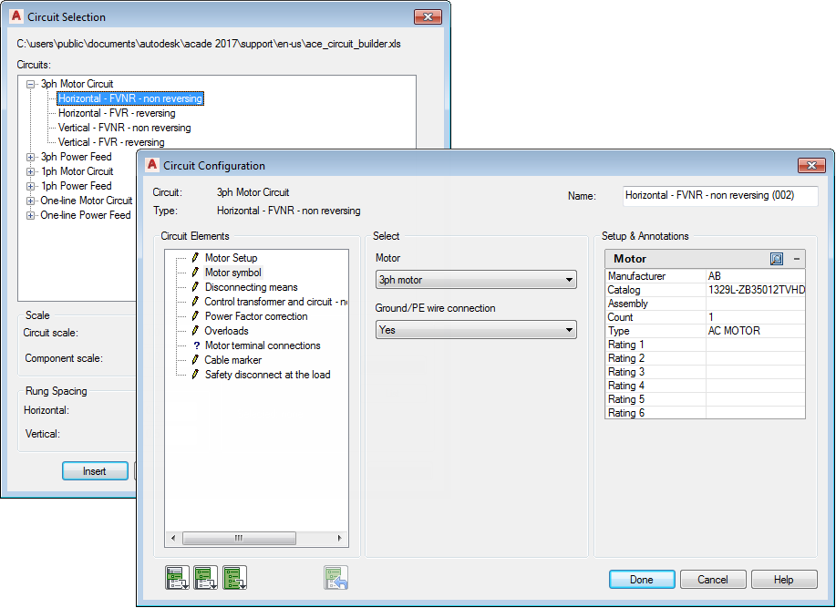

Use Circuit Builder to insert motor control and power feed circuits. Select from various circuit options. Find
The circuit is built dynamically based on your selections.
