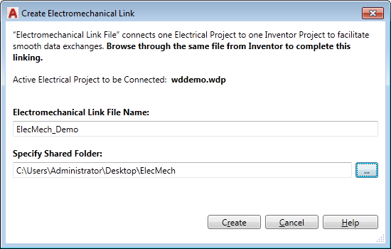

  4. On the Electromechanical Link Setup dialog box, click Create.
  5. On the Create Electromechanical Link dialog box, enter the filename and folder for the link file.

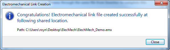

  6. Click Create.
  7. Click Close.

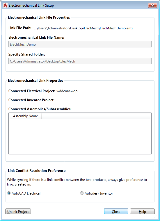

  8. On the Electromechanical Link Setup dialog box, select your Sync Settings. The default setting is AutoCAD Electrical. The assumption is that AutoCAD Electrical users would be initiating the electromechanical workflows most of the time; hence the default is set to AutoCAD Electrical when a component link is created.
  9. Click Close.

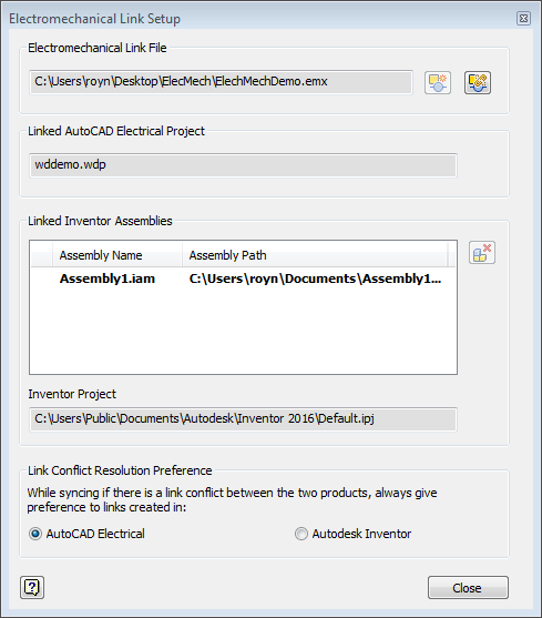

  2. Click Electromechanical tabSetup panelElectromechanical Link Setup.
  3. Click on the Electromechanical Link Setup dialog box.
  4. Browse to and select the .emx file created in AutoCAD Electrical.
  5. Click Close.
    Note: The Sync Settings, in Inventor, displays the same selection for the option that you selected during the electromechanical project creation in AutoCAD Electrical.
