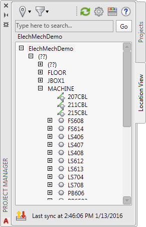

Location View Tab (Project Manager Dialog Box)
Displays the devices in the project, organized by Installation and Location. Devices include standard components, terminals, PLC modules, and cable markers.

Component Tree
Displays a list of standard components, terminals, PLC modules, connectors, and cable markers. The top node in the tree represents the entire project. Each node under the project represents an Installation value. The nodes under each Installation represent the Location values within that Installation.
The various device types are represented differently in the component tree. When inserting electrical components, it is recommended that you should have unique names (installation code, location code, and component tag), pins, and terminals numbers. For example, if you have cable markers in your drawing, which has duplicate values for cable tag, then you may experience unexpected behaviour of the component in the component tree view and in the connections tab. This is more commonly observed for terminals and cable markers in Location View.
Standard Component
Tag value. Expand to view assigned pins.
Terminal
Tagstrip value: terminal number. A multi-level terminal lists each terminal number separated by a comma. Expand to view the level descriptions.
Note: Terminals that take on the wire number show the wire number in place of a terminal number.
PLC
Tag value. Expand to view each pin and address value.
Connector
Tag value separated into two rows, one for the plug side and one for the jack side. Expand to view the pins.
Cable
Tag value.
Child
A child component is excluded from the tree until the parent is inserted.

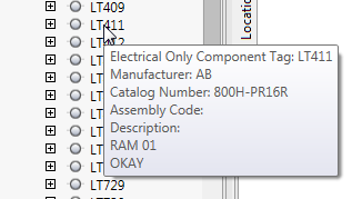

Note: Hover over a device node to display more information about the device, such as catalog and description.
