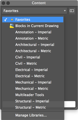

Libraries List
Displays the available libraries. Select a library to insert blocks from or select Manage Libraries to display the Manage Content Libraries dialog box. The following libraries are available by default:
  • Favorites - Blocks that you have selected as favorites from the Blocks list.
  • Blocks in Current Drawing - Lists the blocks in the current drawing that you can create new inserts from.
