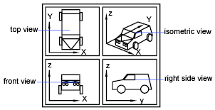

Orthographic
Restores the predefined orthographic view you specify to the current viewport.
The view orientation of the specified orthographic view is based on the UCSBASE system variable, which is set to the world coordinate system by default. When one of the orthographic views is restored, the program zooms to the extents in the current viewport.
