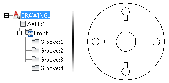

In this example, a folder, Groove:1, contains the upper groove and is arrayed to create the others. Because folders are associative, modifying one groove results in all grooves being updated.
