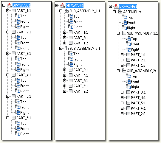

For example, the mechanical browser shows the hierarchical organization of components so you can quickly identify structure of an assembly, similar to how you would in a 3D CAD tool for manufacturing, such as AUtodesk Inventor. You can also use the right-click menu on the mechanical browser for component-related operations. Similarly, you can use the selection modes to click objects in model space and select parts and assemblies, instead of lines, arcs, and circles.
Examples of mechanical browsers
Organizing geometry as components in a 2D environment has special requirements that are addressed by mechanical structure.
For example, in a 2D environment, a part or assembly is typically represented by one or more views. To support this, mechanical structure provides a mechanism to group geometry as views of components (as opposed to grouping geometry directly for a component). In the mechanical browser tree, component views are directly attached to component nodes. Each component contains one or more component views.
In the mechanical browser, a part is a component that consists of component views only. An assembly is a component that contains other components.
