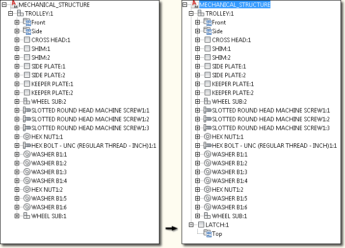

In a 2D environment, a part or assembly is typically shown by one or more views.
Model space contains the views of parts and assemblies. Grouping lines, arcs, and circles (geometry) as parts means that you group geometry as the views of part components.

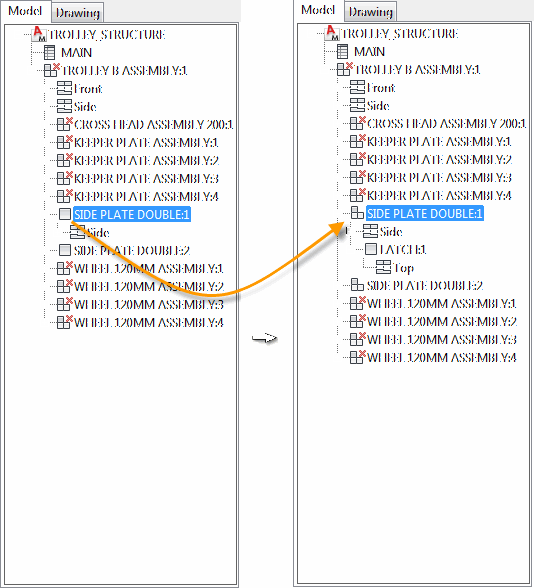

A part component contains geometry while an assembly component contains other components. The component views of a part component contain geometry, while the component views of an assembly contain the component views of the parts and subassemblies that belong to the assembly. In the mechanical browser, part nodes are indicated by the icon and assembly nodes are indicated by the icon.
There are no explicit commands to create assembly components. When a component view is made to contain the component view of another component (as opposed to containing geometry), it is automatically promoted to an assembly.
